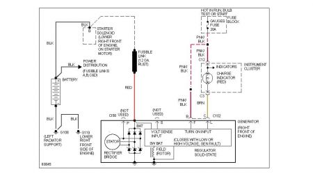

Alternator not working after engine washing
Thursday, August 7th, 2008 AT 1:53 AM
MECHANIC
75,992 POSTS
Check the gauges fuse 20amp if okay you probably short circuited the alternator-get it load tested to find out more-
