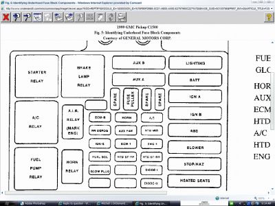

Check these fuses again! In the cab, #8, under hood, IGNA, and IGNB
https://www.2carpros.com/forum/automotive_pictures/62217_Fuses_3.jpg
