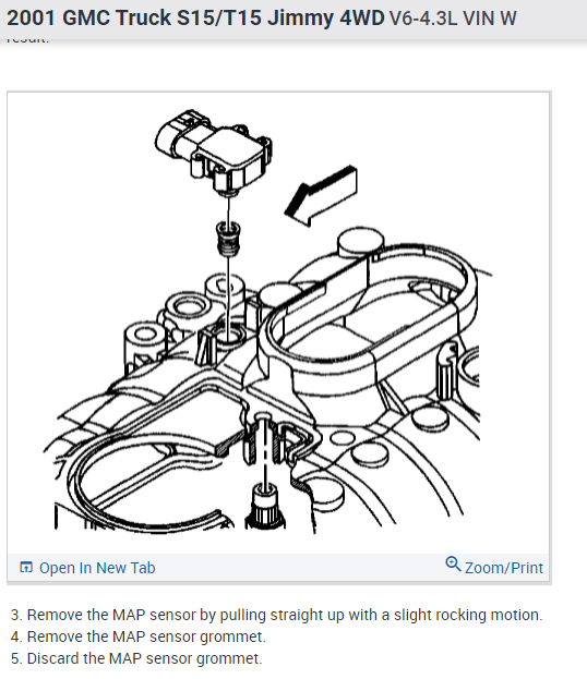

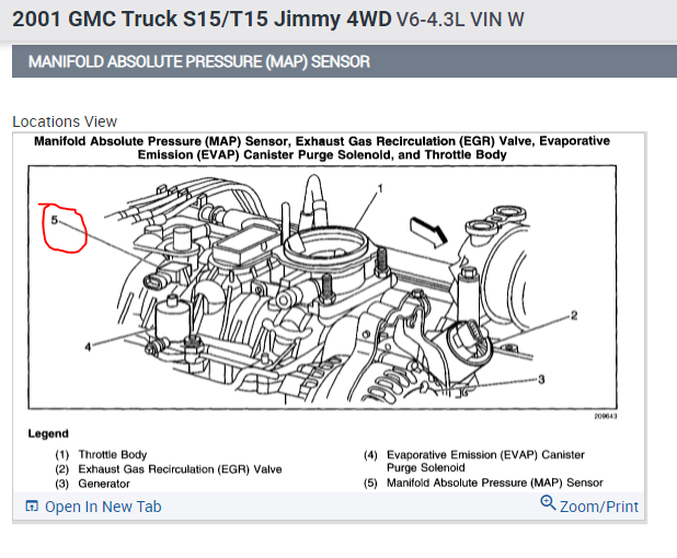

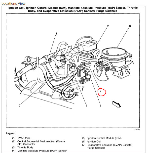

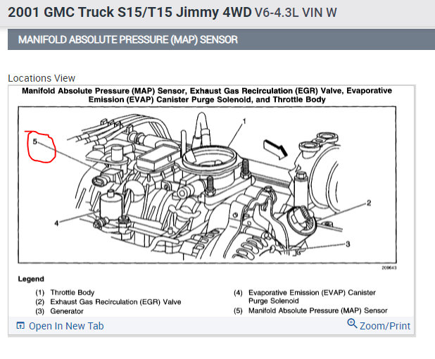

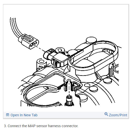

Where is the MAP sensor located?
Sep 30, 2010 at 8:26 PM
SQM
  • CAR REPAIR CONTRIBUTOR
  • 6,383 POSTS

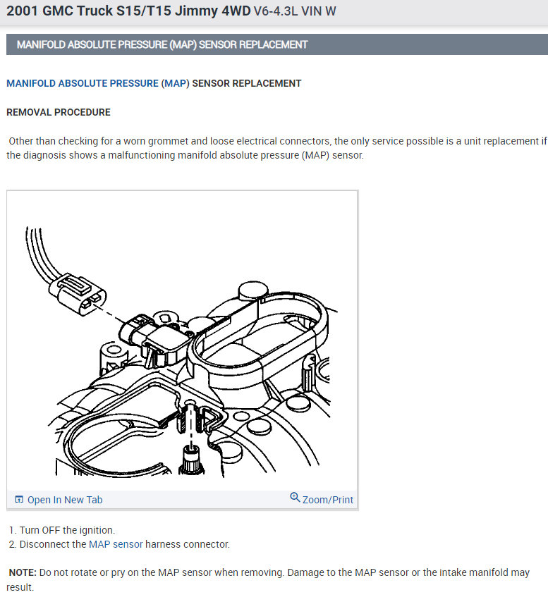

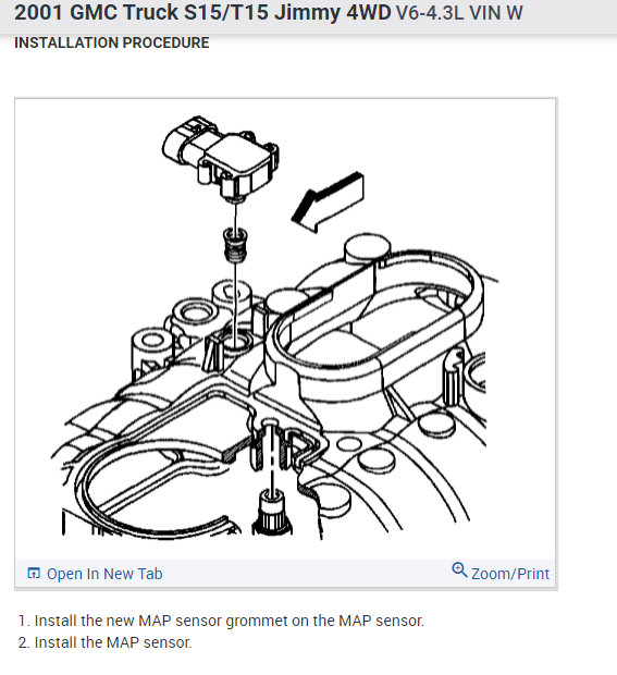

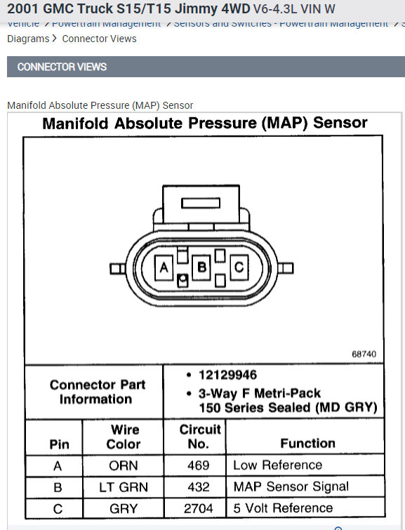

The MAP sensor is located on the top of the engine behind the throttle body. I have attached the location diagram below.
Replacing the MAP sensor is quite simple. All you will have to do is take off the wiring harness off of the sensor then pull out the sensor using rocking motion. Be careful not to get any dirt or debris in the hose that the sensor goes in.
