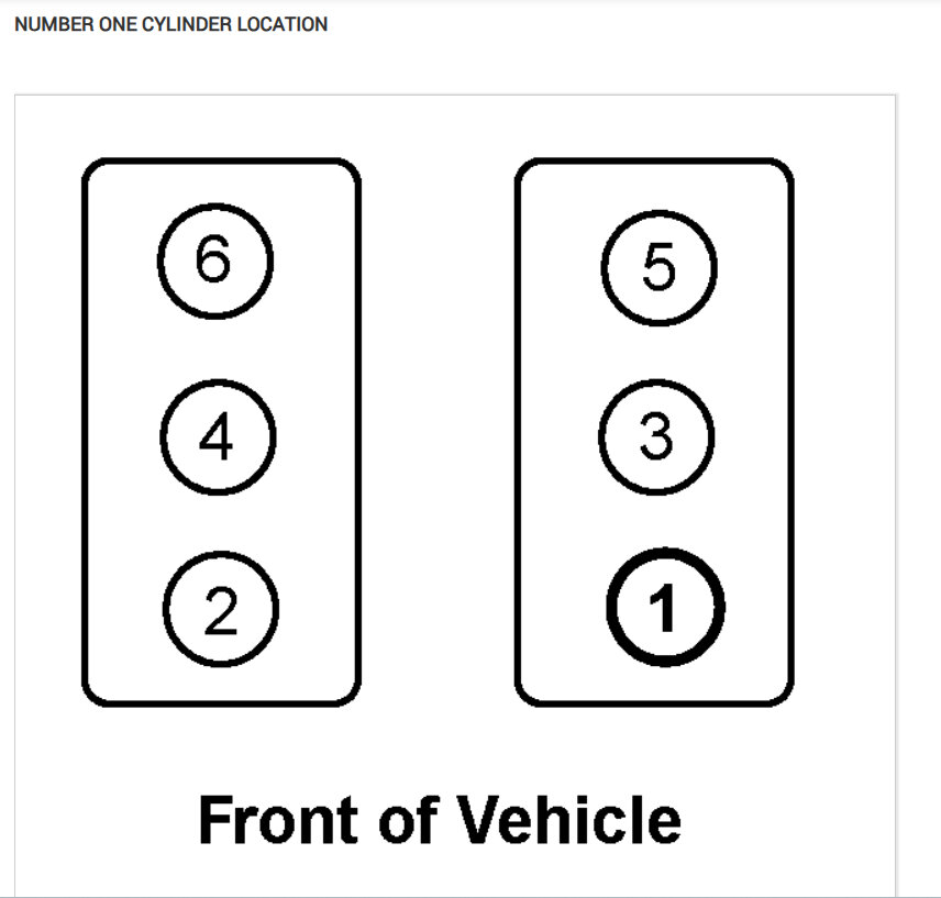

Need to know the DIRECTION of the firing order of spark plugs

Only one engine in this car
Firing Order. 1-6-5-4-3-2
Image (Click to make bigger)
