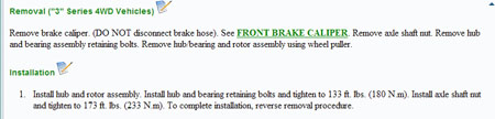

i got to replace rotors on 4 wheels drive 2500 gmc tuck, how do i get them off? i cant remove them what are some tips?
