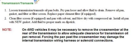

I lost the manual for my truck. Can you explain where the transmission filter is and how to change it.

Transmission filter is located in the transmission pan. Below are proper steps to drain, replace filter, and refill auto tranny fluid.
