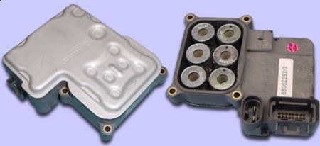

Perhaps it's not a coincidence. This model year, though more common in the 4X4 styles had a string of the Electronic Brake Control Unit (EBCU) failures. The symptoms were a growling noise on all the time even at stops with the vehicle in park and sometimes the key turned off. Does the noise you have been experiencing sound like the ABS is activated like if the vehicle were sliding? If so the ABS module requires replacement.

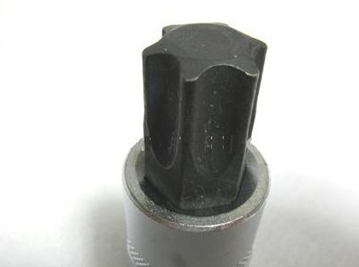

These are easy to replace, but depending on the area you live in could have some corrosion on the small bolts holding it in place. Just be sure you have the torx socket straight on with the bolt and twist with firm even pressure. It is located on the drivers side under the vehicle tucked next to the frame rail just behind the drivers seat on the inside of the frame.
https://www.2carpros.com/forum/automotive_pictures/435113_ABSmodulechevyTruck_3.gif
https://www.2carpros.com/forum/automotive_pictures/435113_torx_3.jpg

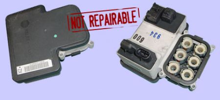

Be sure the ignition switch is turned off before starting. Once you have it out the vehicle is okay to drive, just cover the hydraulic unit on the vehicle with tin foil. The repair will cost between $130 to $700 depending on which one your vehicle was equipped with. Some styles can be sent in for repair in just two days at an inexpensive price. If you have the non repairable style the dealer has many in stock to put on the same day at the more expensive price.
REPAIRABLE UNIT
https://www.2carpros.com/forum/automotive_pictures/435113_1_2.jpg
https://www.2carpros.com/forum/automotive_pictures/435113_2_2.jpg
https://www.2carpros.com/forum/automotive_pictures/435113_3_2.jpg
