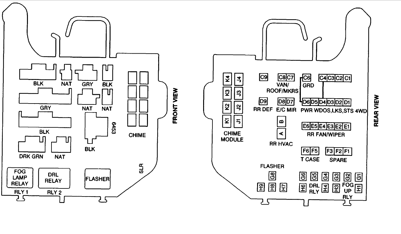

Could you tell me where the turn signal flasher is located on my truck? Thanks.
Well my blinkers do not work at all now, but they used to work sometimes and then would not work at other times. Does this sound like it could be a bad flasher?

The flasher is located in the fuse panel under the dash here is a diagram (below) to help you see. FYI
