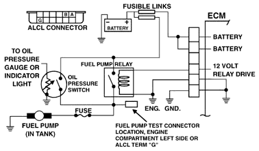

If the fuel pump works ok when the car is running why isn't there gas to get it started? Bcuz the fuel pump and oil sending unit is providing the power when the engine's oil pressure is above 4lbs and running.
Your problem is coming from these possible areas computer relay control, fuel pump relay,fuel pump and its wiring-
Check the fuel pressure and look for excessive voltage drop in the circuit. See below circuit
https://www.2carpros.com/forum/automotive_pictures/12900_oil_sending_unit_and_fuel_pump_circuit_37.gif
