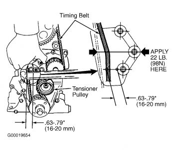

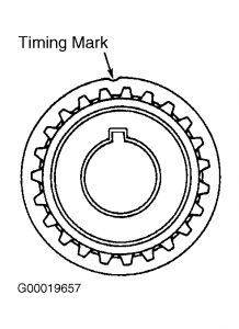

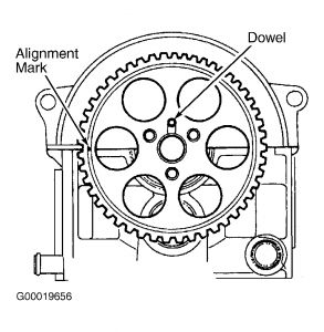

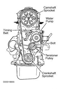

What is the crankshaft timing
Sunday, December 21st, 2008 AT 11:37 AM
ZACKMAN
MECHANIC
4,202 POSTS
Is this what you need?
Camshaft sprocket
Crankshaft sprocket
Timing cover area
Torque specs
