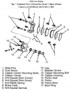

Thanks so much for your response. As I said, I'm not very familiar with cars, though I would like to learn.
I'm fine with figuring stuff out as I go, but if I could get pictures of what some of these parts look like it would be very helpful.
I'd specifically like to know how to identify the piston dust cover and slider bolts.

Here is a diagram of the front brake caliper assembly.
https://www.2carpros.com/forum/automotive_pictures/192750_CaliperFrtBrake96PrizmFig07_1.jpg
