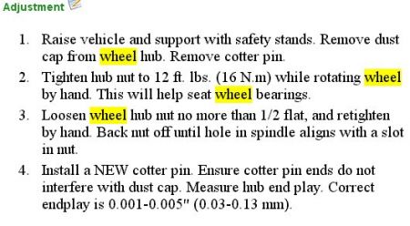

I have a constant whine in my front end as i drive faster it gets louder and quieter as i slow ,but it doesn't go completely away I have replaced the the rotors and brakes and had a grease job done. I was told it might be the axle bearing. the 200 GMC jimmy ran fine, we parked it 1 night the next morning the notice started. If this is correct how do I replace the bearing, I know how to replace bearings on other cars, but I don't know how to take off the housing. Any Help please. Thank you

Try adjusting them first, or clean and repack them. (4WD I assume)
