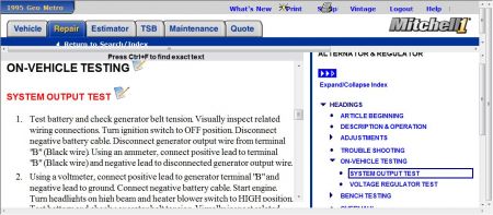

New battery, new alternator. Continuity between bat and alt. 2 prong plug into alt -- when key on 1, prong has 12.42 volts (same as battery. Other has 12.21 volts.
System does not charge.
Whats the problem

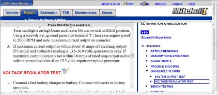

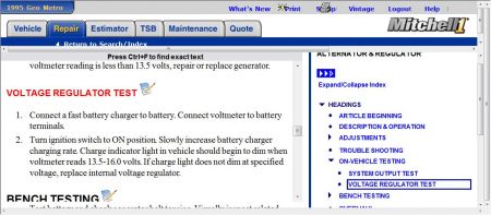

Do below
