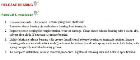

my throw out bearing is toast do I HAVE to replace every thing or can I just replace the bearing?

You can just replace the throw out (release) bearing if you want..replacement procedures are below.

Thank you the local auto shops were giving me the run around and not answering my questions this helped alot
