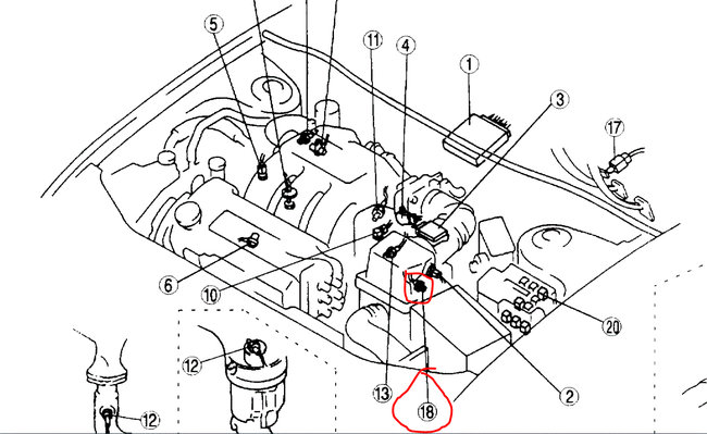

When I start the car, put it on drive the car won't move, but when I put it on revers gear it moved. Now there is notice when I put in gear.
Monday, March 9th, 2020 AT 4:31 PM
  • 110,194 POSTS

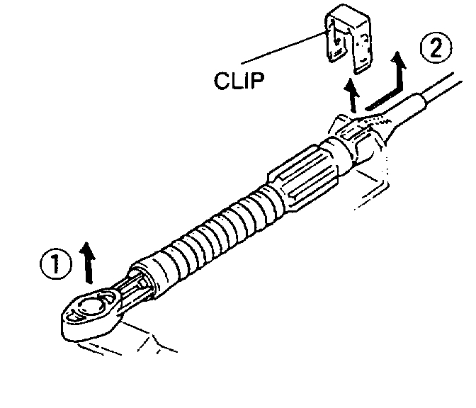

When you say there is no notice when you put it in gear, do you mean the gear indicator doesn't show the selected gear? If that is the case, the vehicle has what is called a transmission range sensor. That is where I would start.
The sensor is under the air box. See pic 1.
After you locate the sensor, here are directions for adjusting it. I'm adding this in the event something has come loose. Also, have a helper move the shifter to confirm the cable is moving the sensor lever.

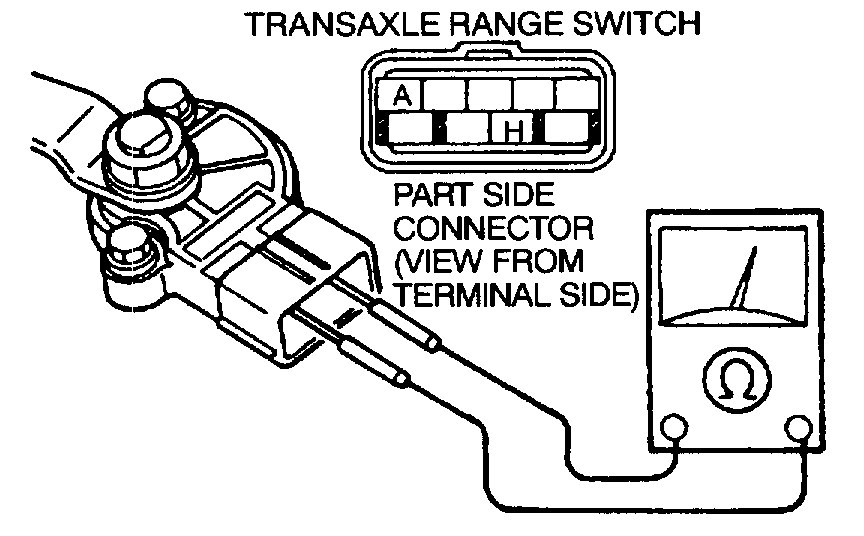

7. Connect an ohmmeter between terminals A and H.
8. Adjust the switch to the point where there is continuity between the terminals.

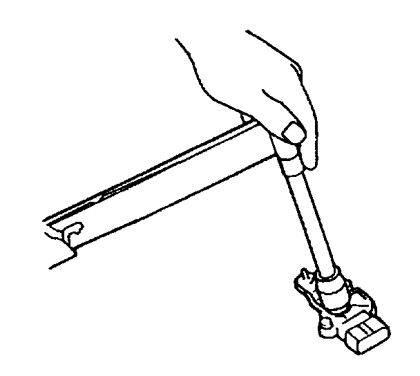

9. Tighten the transaxle range switch mounting bolts.
Tightening torque
7.9 - 10.7 Nm (80 - 110 kgf. Cm, 69.5 - 95.4 inch lbs.)

Pic 4
5. Remove the selector cable in the order shown in the figure.
1. Disconnect the selector cable from the manual shaft lever.
2. Pull out the selector cable from the cable bracket and remove it.

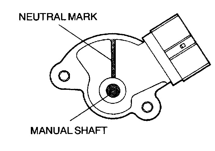

9. Rotate the manual shaft to converter housing side fully, then return 2 notches to set the neutral position.
Pic 5
10. Turn the transaxle range switch so that the N mark is in line with the flat, straight surfaces on either side of the manual shaft.
11. Hand tighten the transaxle range switch mounting bolts.
Pic 6

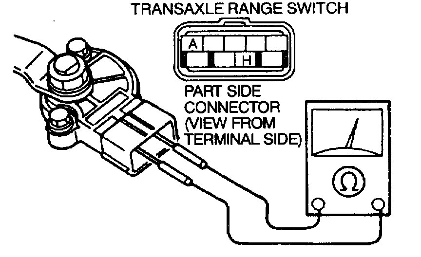

12. Verify that there is continuity between terminals A and H of the transaxle range switch connector.

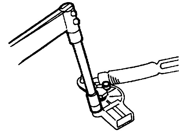

13. Tighten the transaxle range switch mounting bolts.
Tightening torque
