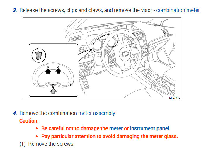

The miles displayed on the odometer are not accurate to the miles driven. The miles shown decreased more than miles driven drove 16 miles and displayed showed 100 miles down.

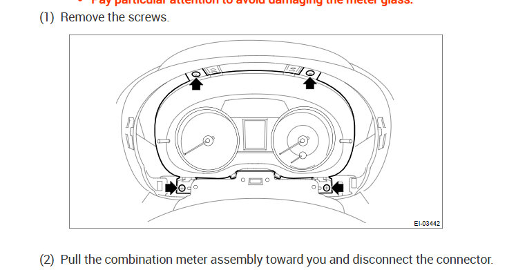

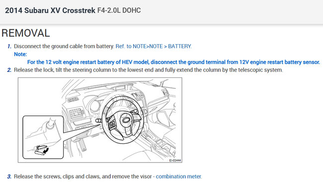

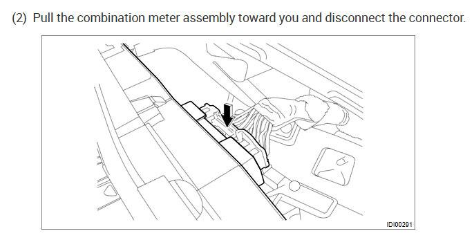

Yep, the microprocessor inside the instrument cluster has gone bad and needs to be replaced. Here is how you can get a used/rebuilt unit if you search eBay or Google. Check out the images (below). Let us know if you need anything else.
