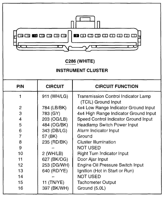

Looking for a pinout diagram for the gauge cluster.

Sure, here is the pinout diagrams for the instrument cluster. Check out the images (below). Let us know if you need anything else.
Image (Click to make bigger)
