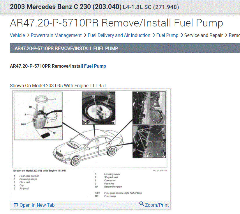

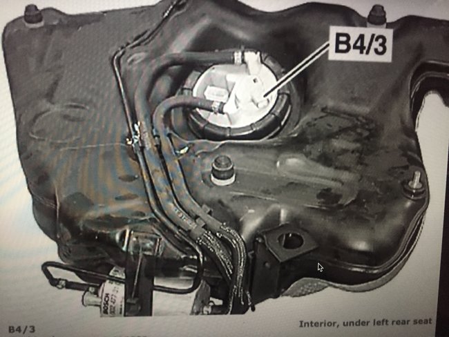

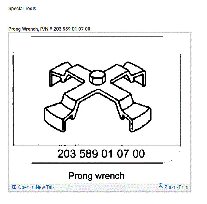

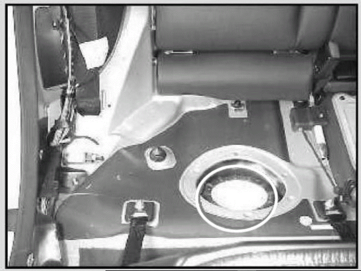

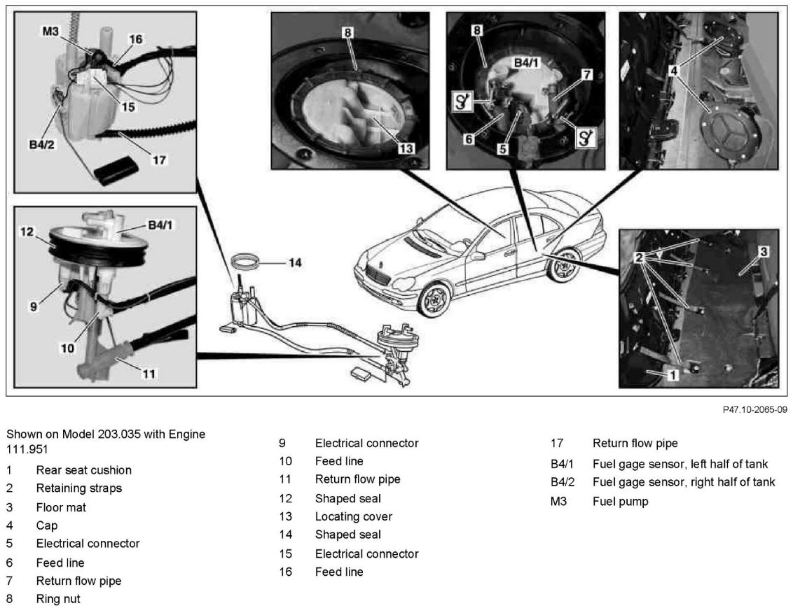

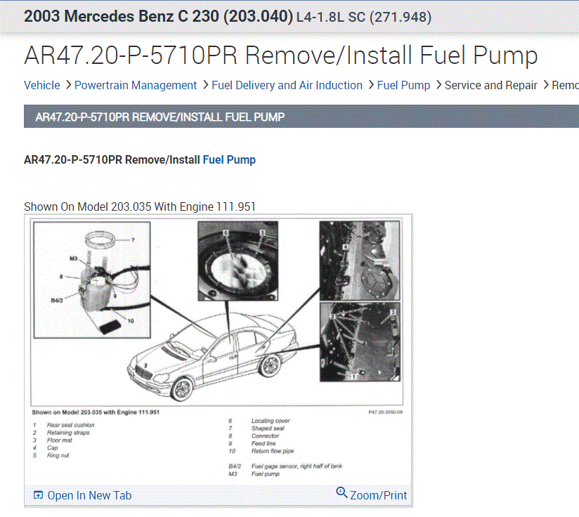

You are lucky on this one. The fuel tank doesn't need to be removed, There is an access port under the right rear seat that can be removed to access the top of the fuel pump and module assembly.
If you look at the pics below, it explains how to remove and replace the fuel pump assembly. If you look at pic 1, it shows the location of the access port. The remaining pics explain how to access it.

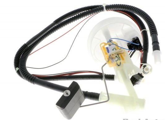

What Joe meant is that to repair it you need to access it and likely replace the assembly if that is what is leaking. This is because Mercedes used a split system with the pump on one side of the tank and the level sending unit on the other, but they are connected by hoses inside the tank. So in order to repair either one you usually need to access both due to the wiring and hoses. If the leak is on the upper side of the tank you should be able to see it through the access ports under the seat. That way you can determine if it's leaking at one of the fittings or if a line cracked or what the issue is. Your description sounds like a failed o-ring in one of the fittings and those are accessible through the back seat ports.

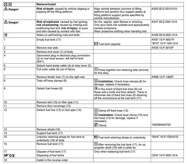

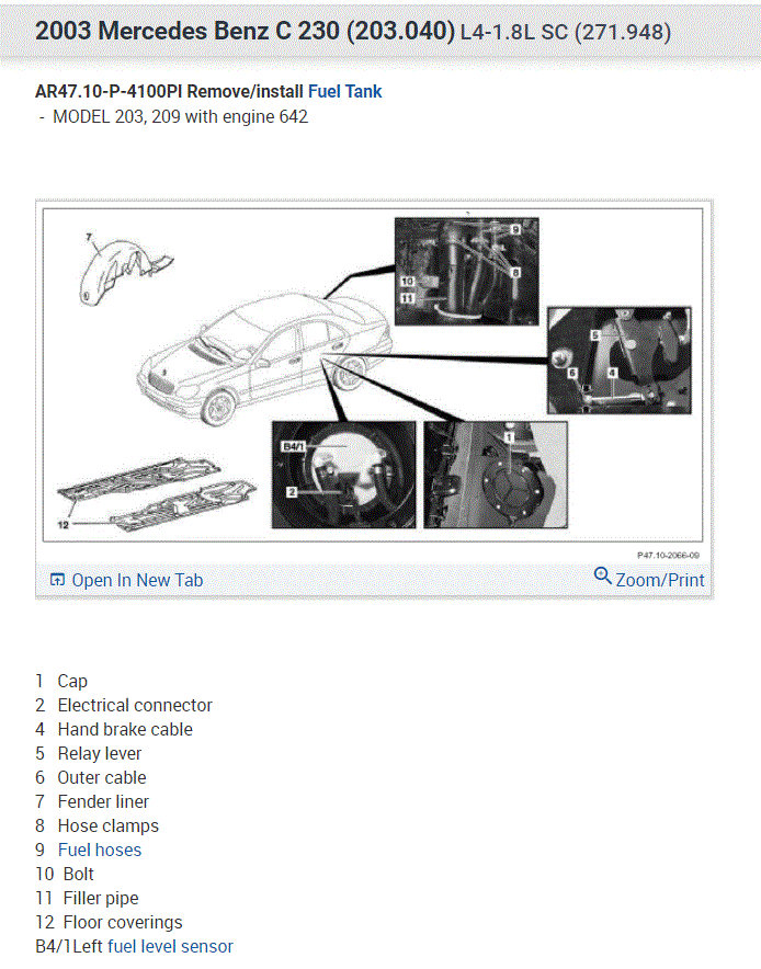

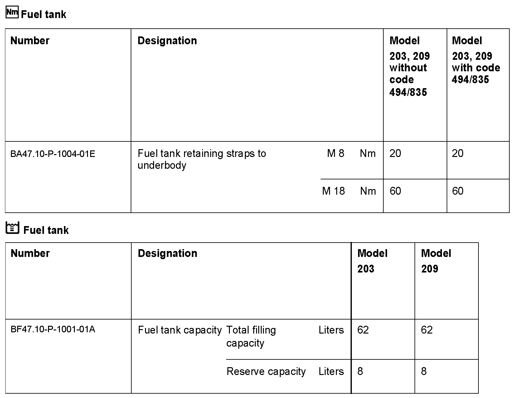

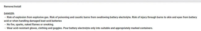

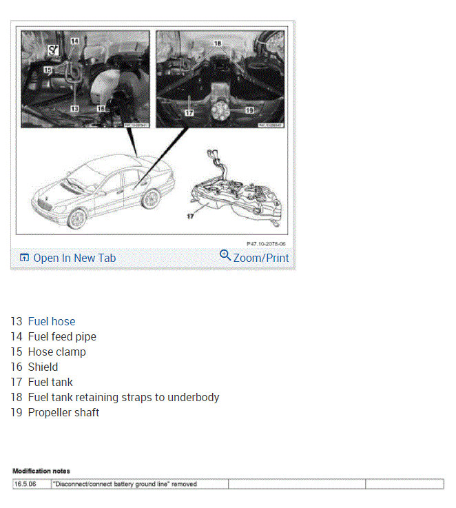

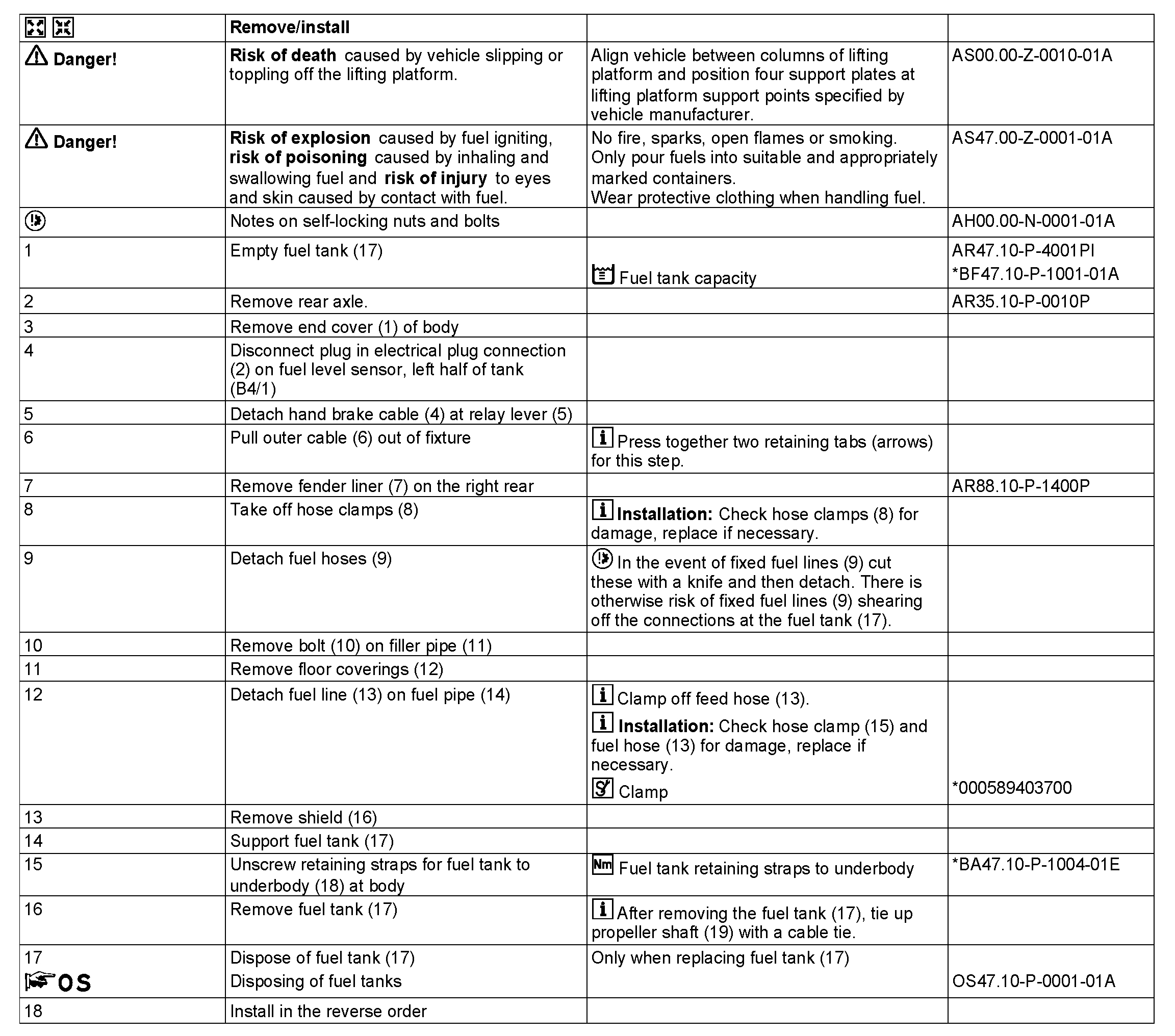

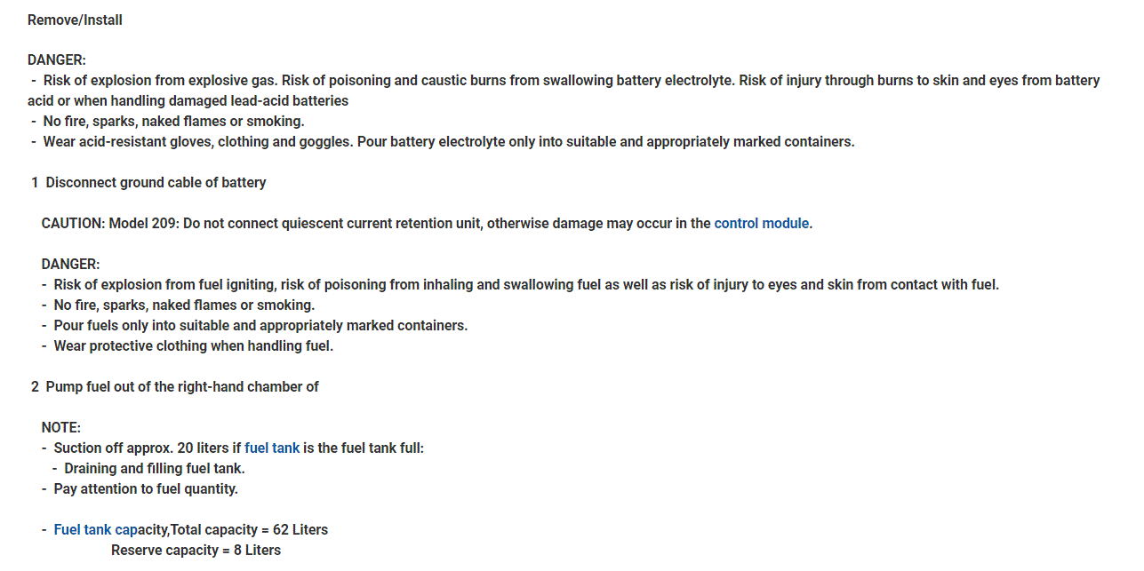

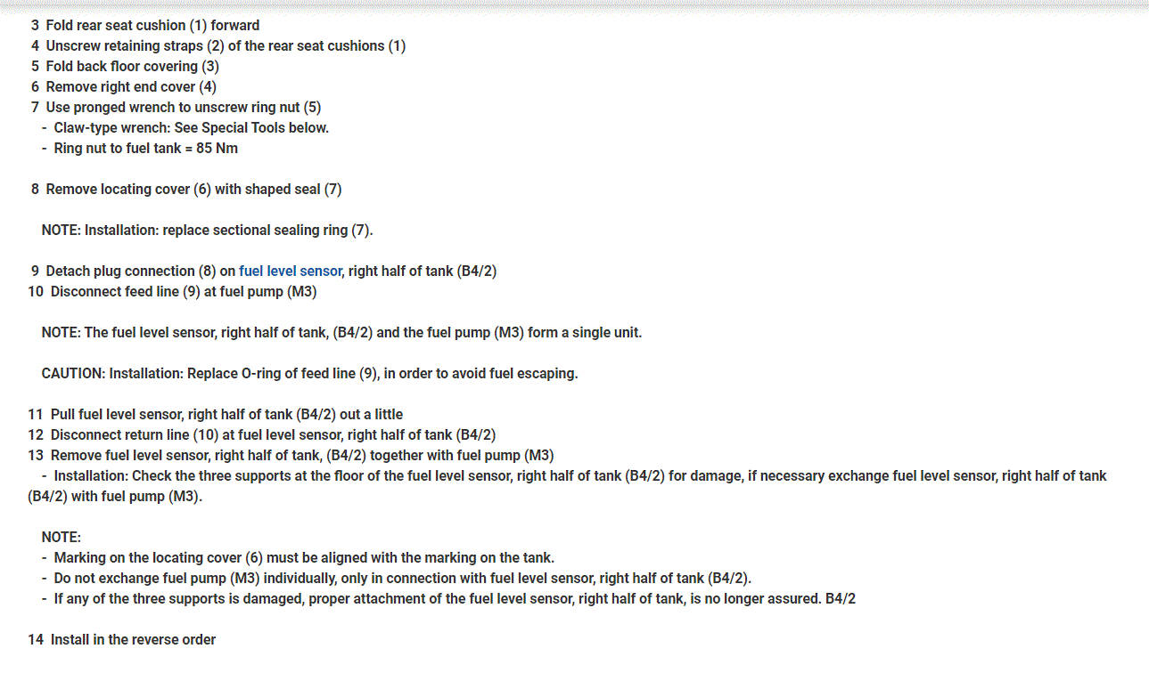

Yep, Steve is correct. That is where I would suspect the leak to be. If you need to, however, I attached the directions for removing the fuel tank. I hope that isn't the case.
If you look at the pics below, they are the directions for removal and install of the fuel tank specific to this vehicle.
I hope this helps. Let us know how things turn out for you.

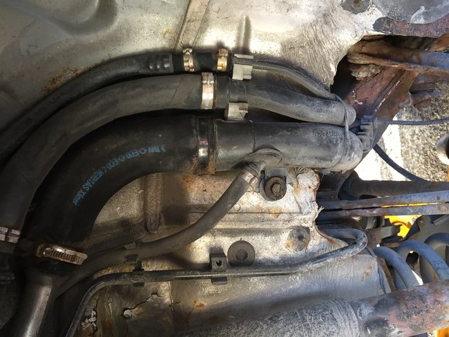

Hi Joe, good evening. I checked both the access ports under the seats and they were dry (no leaks at all). So I think it is the metal line on top of the tank that is rusted? Leaking.I removed the right rear wheel but which fuel tube should I cut, for in the diagram it says fixed fuel lines (9) to cut.I have removed the clip on that hose for your opinion.

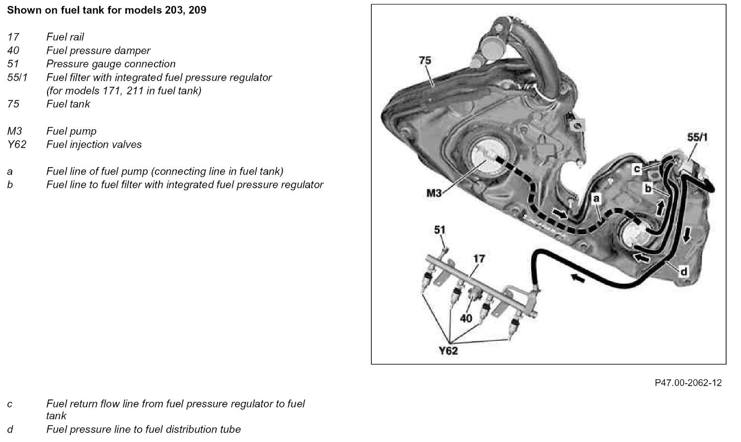

I am sending you the actual picture of the car. The other picture of the gas tank (from the internet) which shows the steel line. So if that is rusted and leaking how should I replace it for it seems it is connected to the gas tank and the other end to the fuel filter. Can I replace it with rubber hose? What is the steel line for?Tomorrow I will partially lower the gas tank so I can have access to the steel line.

IF you are unable to see the leak via the ports, then I honestly recommend removing the tank. If you lower it slightly, you may see the leak but may not be able to repair it.

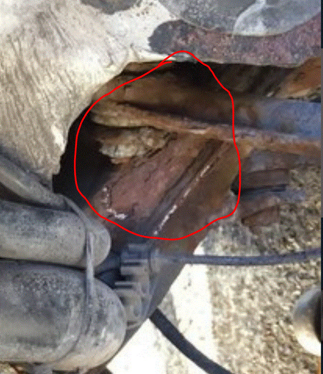

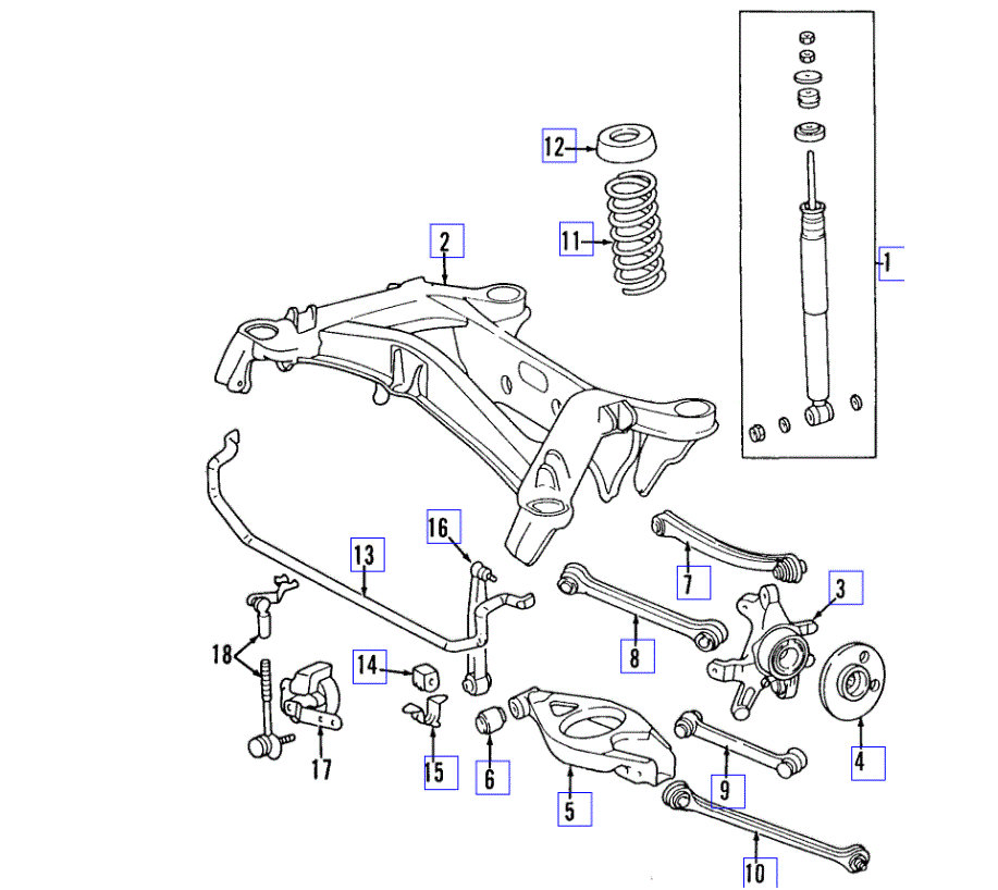

Also, I made a copy of your first picture and circled a component. I'm having trouble orienting myself. If you look at pic 2, can you identify which part I circled? I don't like the looks of that. It looks like either a tracking arm or a control arm. Make sure the rust isn't
to a point it's weak.
Let me know what I can do to help.

I got you Joe. I will look at the car and confirm what that component is that you have circled.I wanted you to comment on the thin metal fuel line on the gas tank, I am sure it is that line that is rusted and?Leaking.

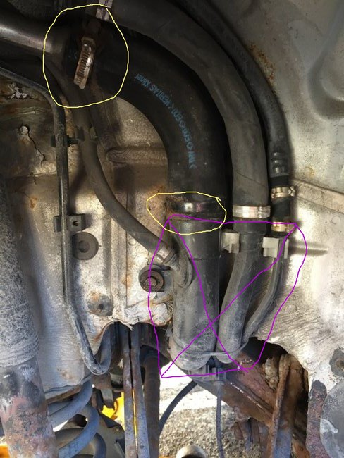

It looks like you are missing one clamp and someone changed the filler neck rubber line already. In this image the yellow circles a missing clamp and a replaced clamp on the filler. The xe'd purple lines should be plastic if I recall so those shouldn't be leaking unless they were cracked. The largest is the filler line, the next largest should be the vent tube and the smaller one to the right is the vacuum line from the EVAP testing.
I would drop the tank and look at the lines before you cut anything. The small line in your internet image that runs from the filter over the tank is the pressure fuel line that runs to the fuel rail. It is D in the image I added, If you want to run the line the factory way you would drop the tank and replace the line all the way to the front of the car. If the line is only rusted over the tank you could reroute it around the tank but only if you can get to the line in front of the tank. You would remove the clamp from the line where it connects to the hose on the fuel filter, then find that line in front of the tank. How you repair it depends on what material you want to use, For steel you could find the front line and cut it in a spot in front of the tank, then run a new steel line from there back to the fuel filter connection, You could likely snake it up over the tank and form it in place, it wouldn't be locked into the tank but as long as you secure it there shouldn't be a problem. The hard part will be connecting the new line to the original. As long as they are the same size and very clean you could use a compression fitting to join them. The system doesn't run at extreme pressure so that would work. However you will want to verify that is okay in your area first.
