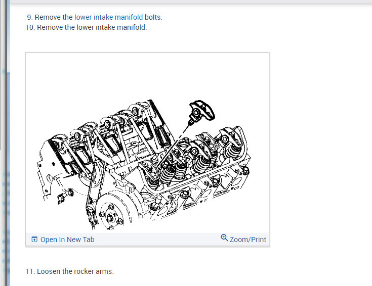

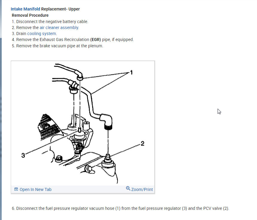

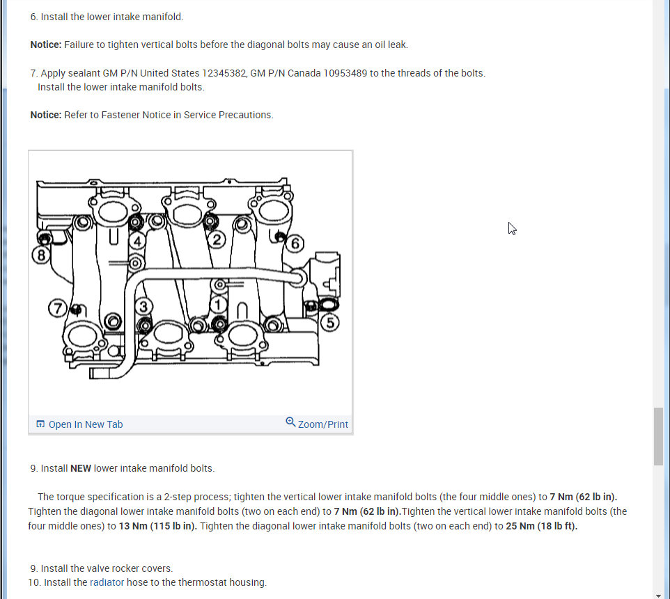

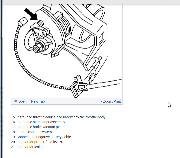

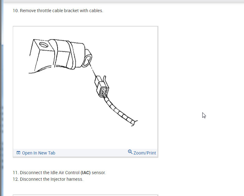

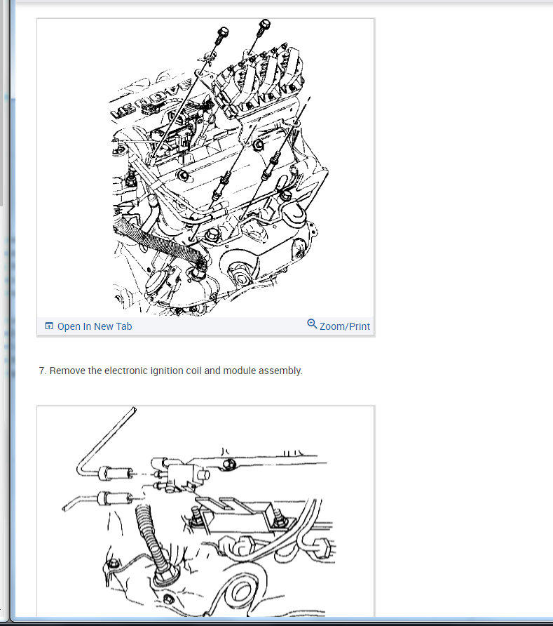

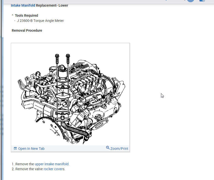

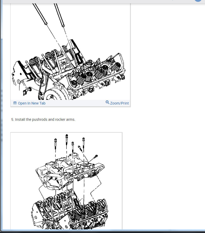

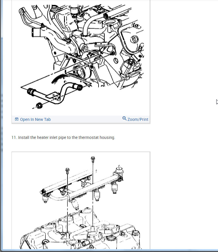

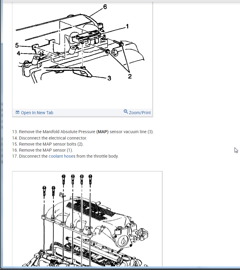

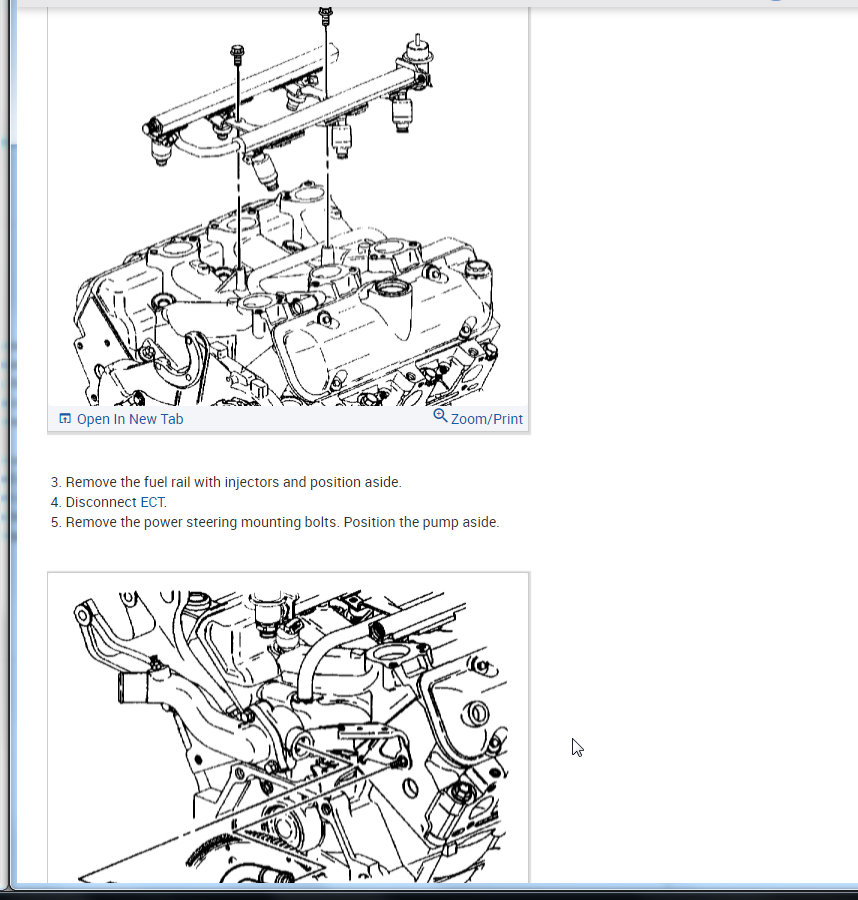

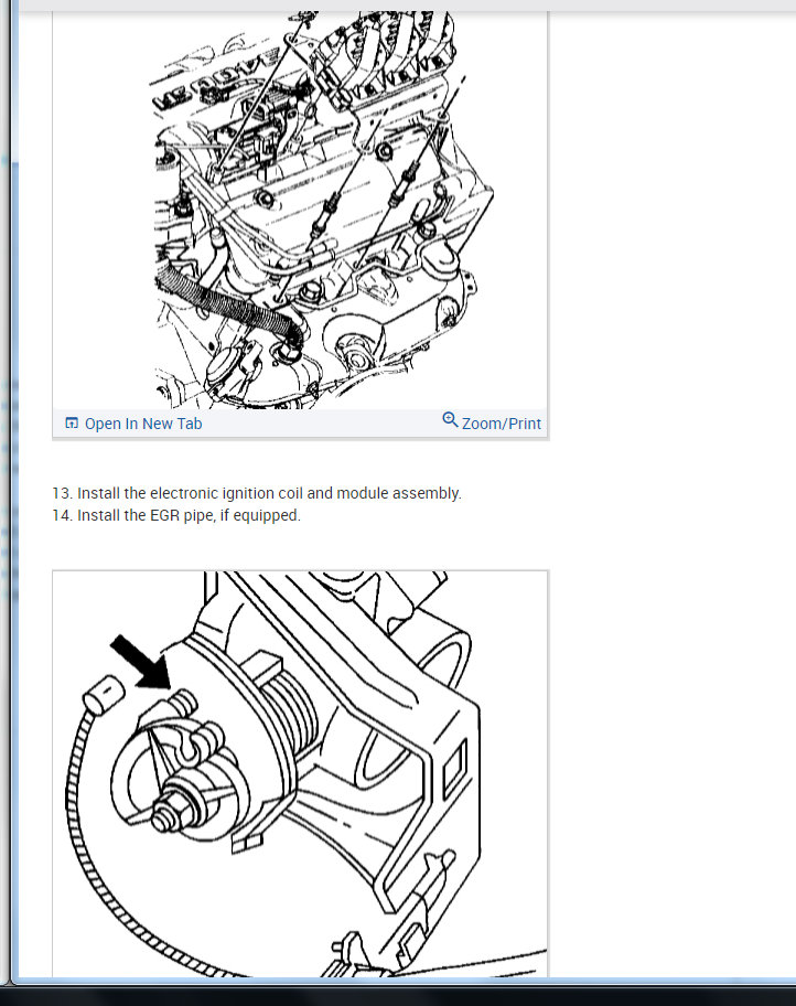

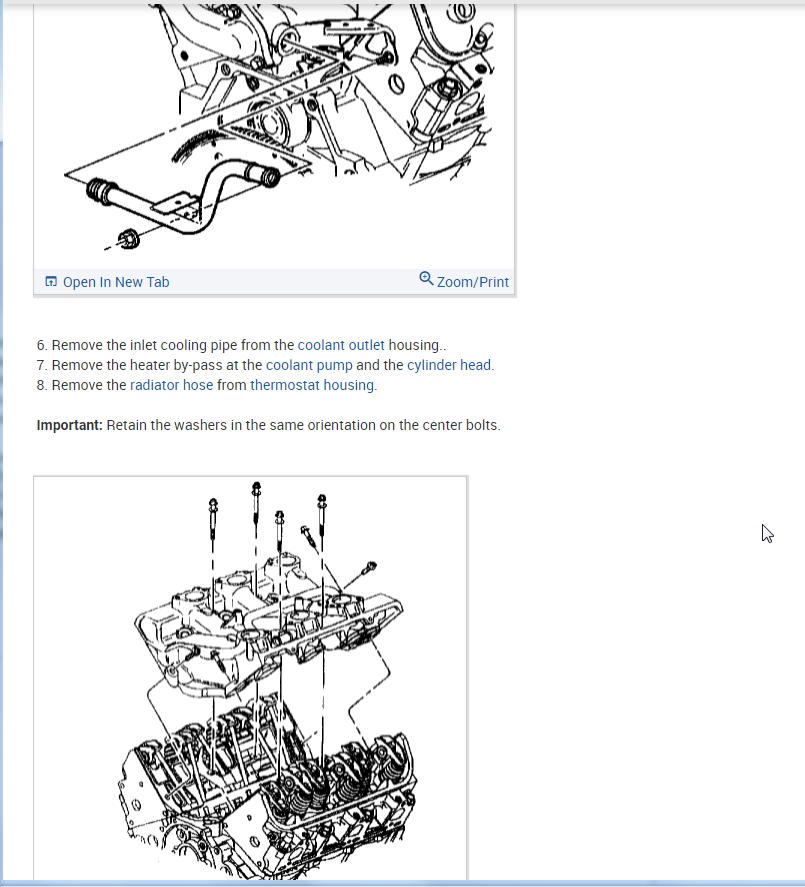

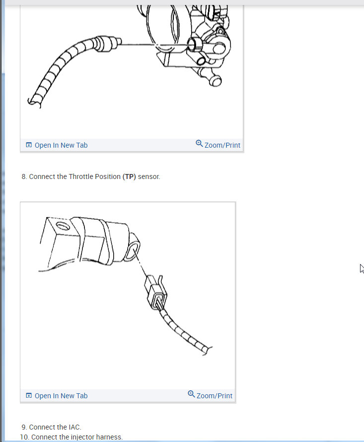

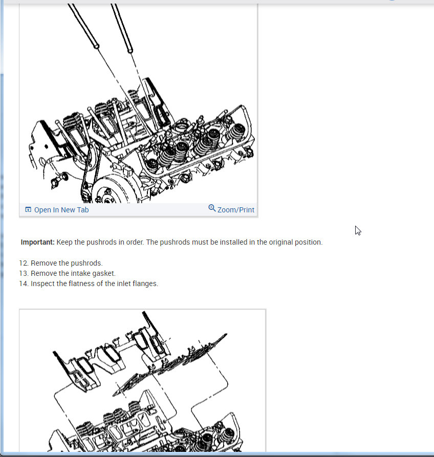

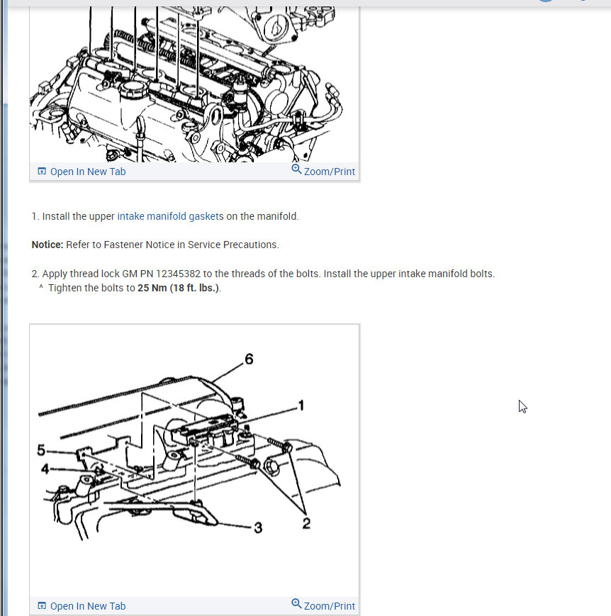

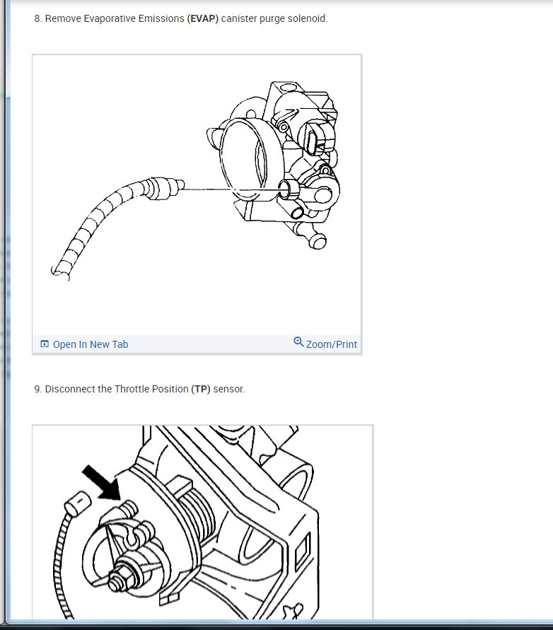

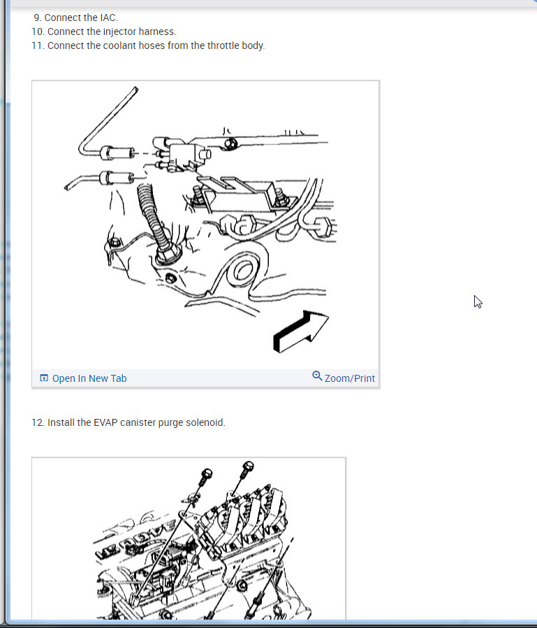

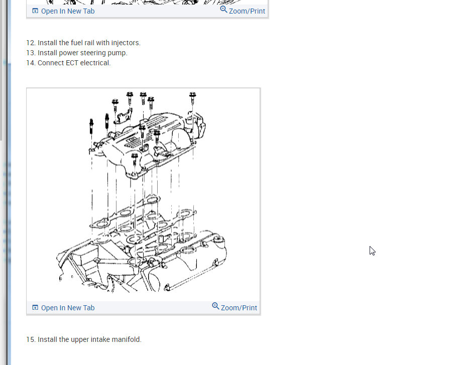

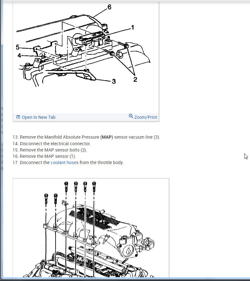

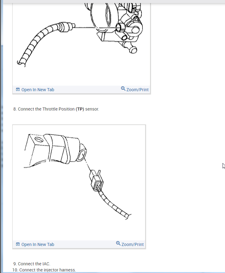

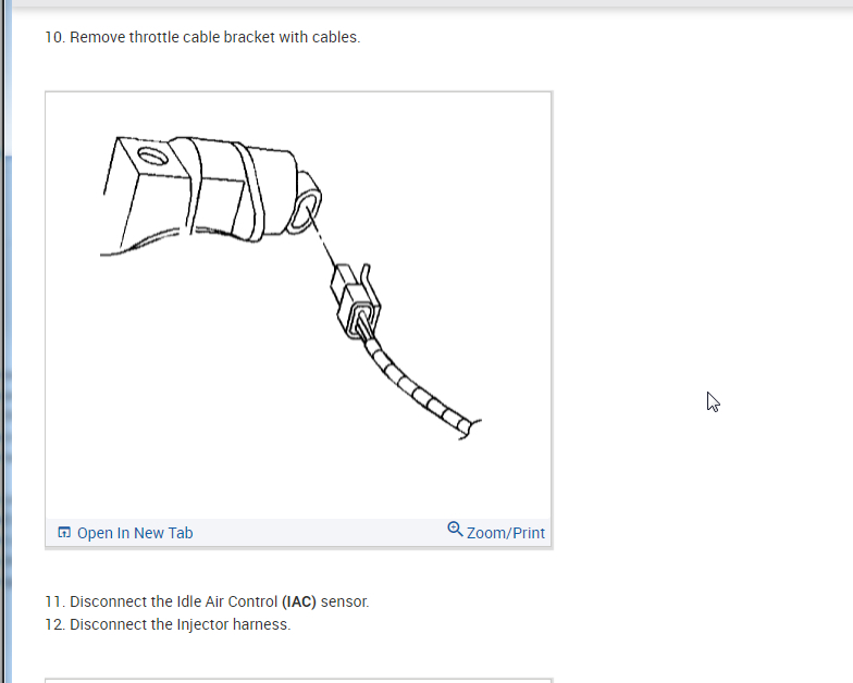

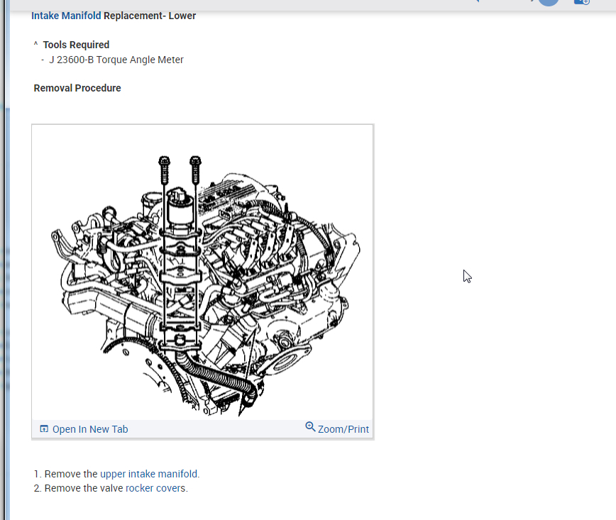

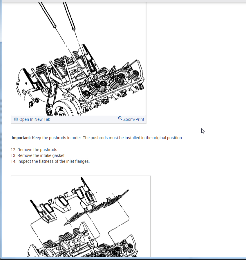

Removal of intake gaskets.
And how to flush the cooling system?
Monday, May 3rd, 2021 AT 12:33 PM
MECHANIC
18,907 POSTS
Here is a guide that will help with the cooling system:
https://www.2carpros.com/articles/coolant-flush-and-refill-all-cars
Below is the process for the upper and lower manifold depending on which you need.
Please let us know if you have other questions. Thanks
