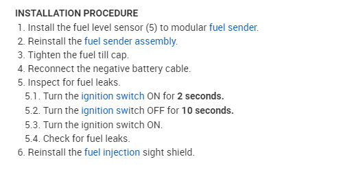

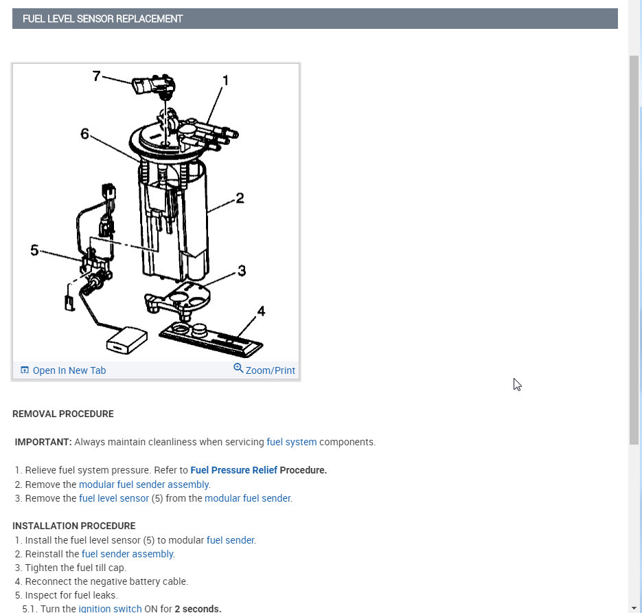

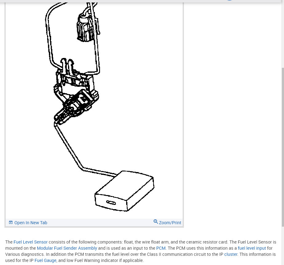

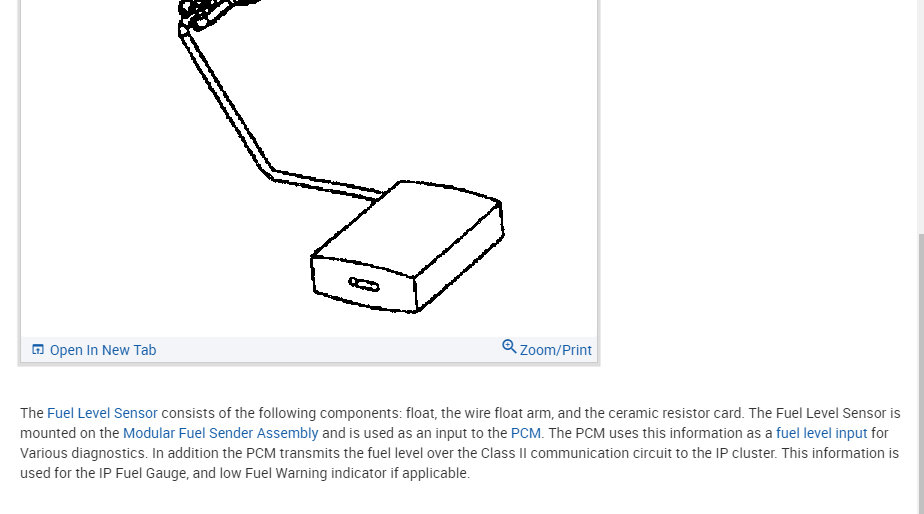

It is possible that the level sensor is off but I am not sure you are looking at this the right way. I attached the info about this for your review. The PCM sends a message to the cluster to display the proper fuel level. However, the fuel warning goes off at a set mileage to empty. This means it may go off after you have driven 228, 200, or 157 miles driven. This all depends on how you are driving and the fuel economy you are getting. Meaning if you are driving slower and light foot, you will get more mileage out of a tank of fuel then driving faster and heavy footed.
Does that make sense?

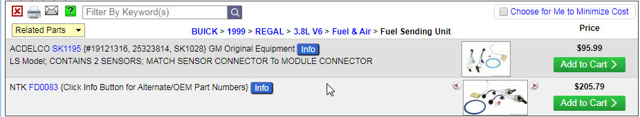

I see. This makes alot of sense. Where is this level sensor located and is it easy to get to. How much will be the cost for a replacement part.
Dec 5, 2019 at 6:25 AM
  • CAR REPAIR CONTRIBUTOR
This is part of the fuel pump in the tank. It appears the price ranges but I would expect the part to be around $200.00. It appears there is a cheaper option but I would shop around a little bit and see what you feel comfortable with.
