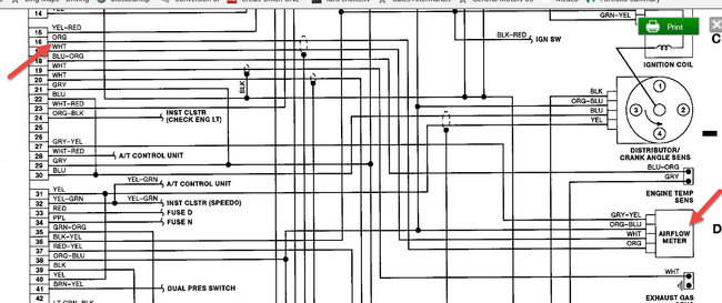

Is there a ECU pinout or wiring diagram for my car with a 1.6l ga16de? Thank you

Yes, but are way too big to post on here. I will send where 16 pin is it is an orange wire that goes to air flow meter. See picture.

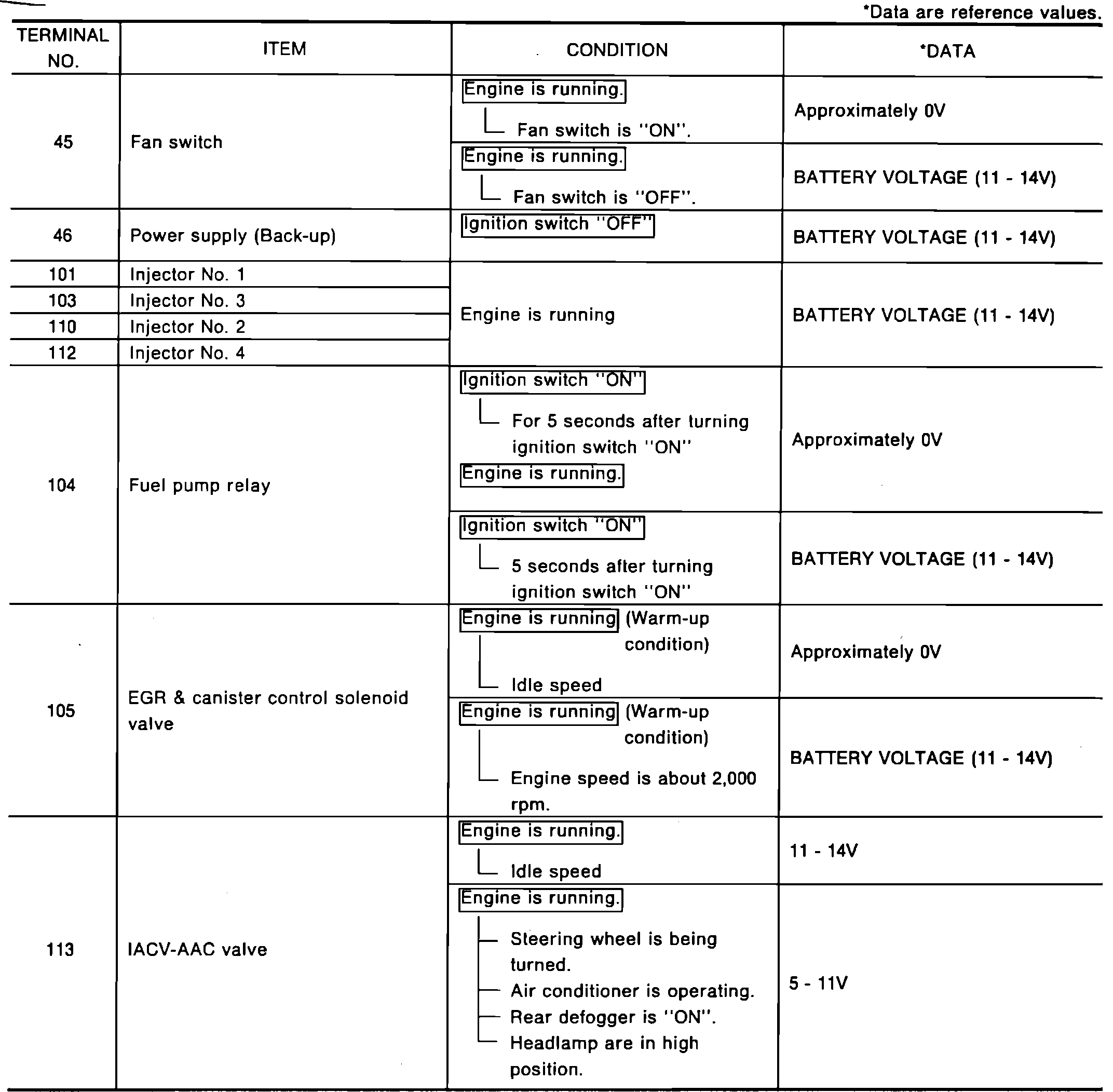

Can you send me ecu pin out for ga16

Here is your ECU pinout and expected voltages. Hope this helps.
