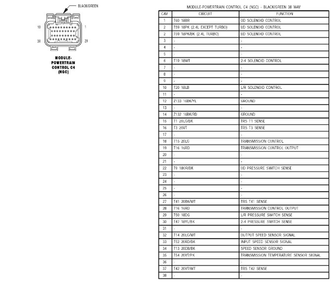

Need to find the fuse for a transmission control module.
Wednesday, November 21st, 2018 AT 8:17 AM
MECHANIC
52,796 POSTS
Good afternoon,
The transmission control module is part of the engine control module.
Does the engine run?
Is the check engine light on? If it is, do you know the code?
I will attach a connector diagram for the ECM that has the controls for the transmission.
