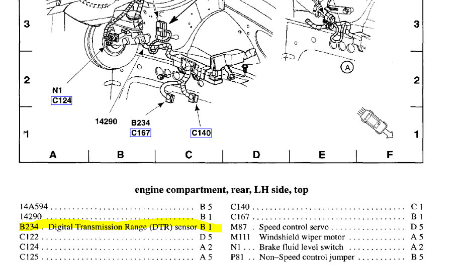

First of all thank you for the information you have been providing. The Ford manual states that fuse 37, 38 is transmission position switch, GEM park neutral switch. What are they and where are they located?
Sunday, March 24th, 2019 AT 4:59 PM
Did you verify that the fuses are the cause of the draw?

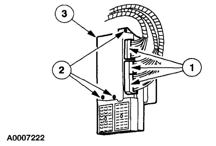

GEM module
REMOVAL
1. Disconnect the battery ground cable. For additional information, refer to Battery.
CAUTION:
Prior to removal of the module, it is necessary to upload module configuration information to the appropriate scan tool. This information needs to be downloaded into the new module once installed. For additional information, refer to Module Communication Network (Information Bus).
Electronic modules are sensitive to static electrical charges. If exposed to these charges, damage may result.
ImageOpen In New TabZoom/Print

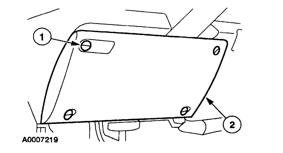

2. Remove the instrument panel steering column cover.
1 Unlock the retainers.
2 Remove the instrument panel steering column cover.
CAUTION: Use care when removing the instrument panel steering column cover or damage to the cover locating tab may occur.

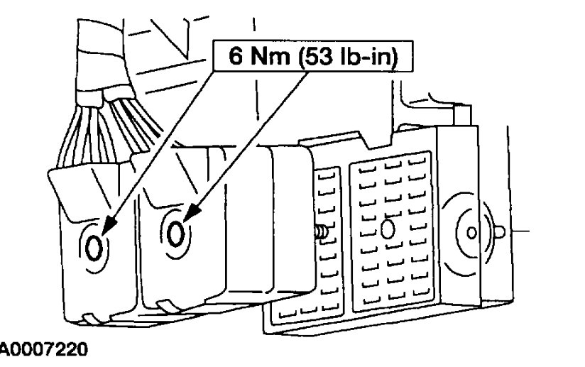

3. Loosen the bolts and disconnect the bulkhead connectors from the instrument panel fuse junction panel.

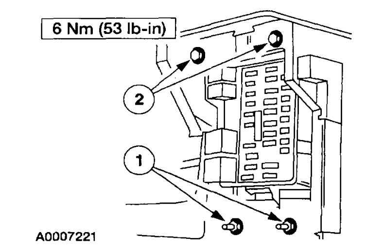

4. Position the instrument panel fuse junction panel aside.
1 Remove the nuts.
2 Remove the bolts.
5. Remove the Generic Electronic Module (GEM).
1 Disconnect the electrical connectors.
2 Remove the screws.
3 Remove the GEM.

The neutral switch is on top of the transmission under the hood.
