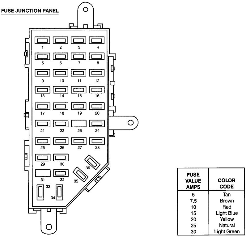

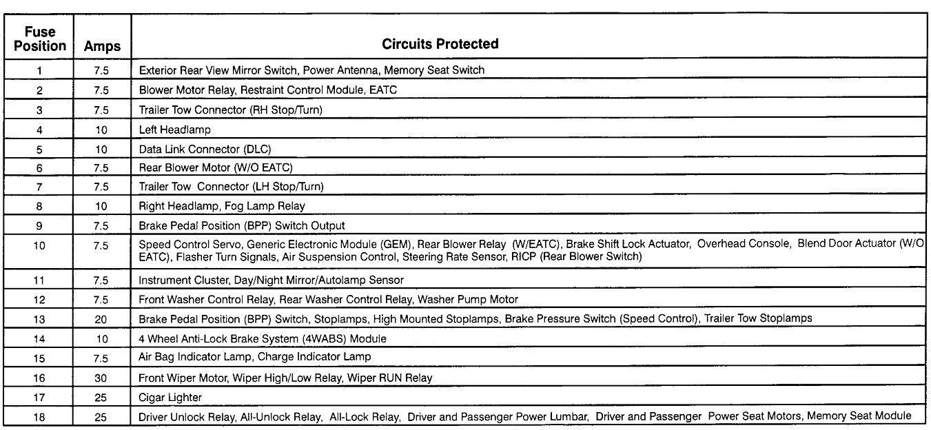

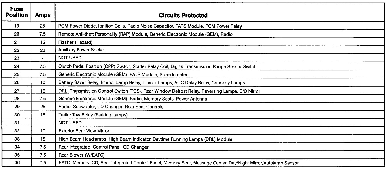

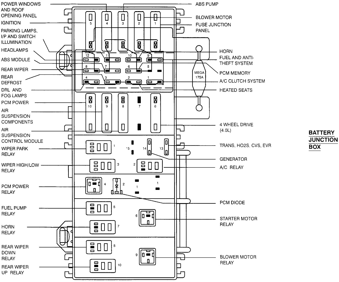

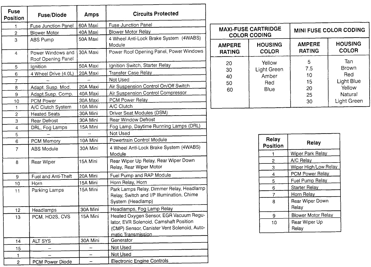

Can I get under the hood and inside vehicle fuse diagram?
1999 FORD EXPLORER
199,000 MILES • 4.0L • 6 CYL • 4WD • AUTOMATIC
RVSNGL

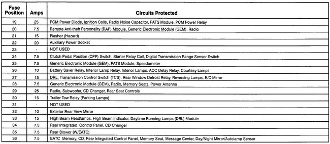

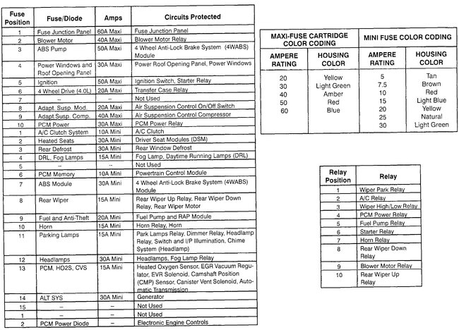

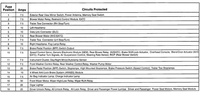

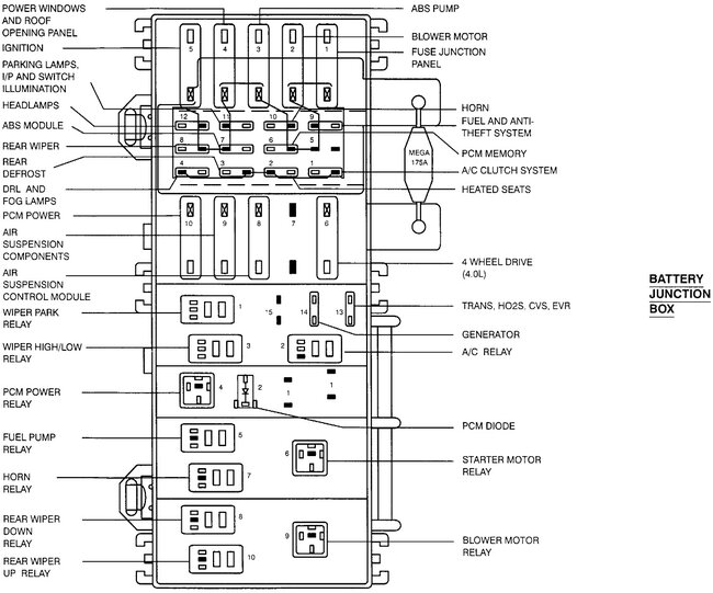

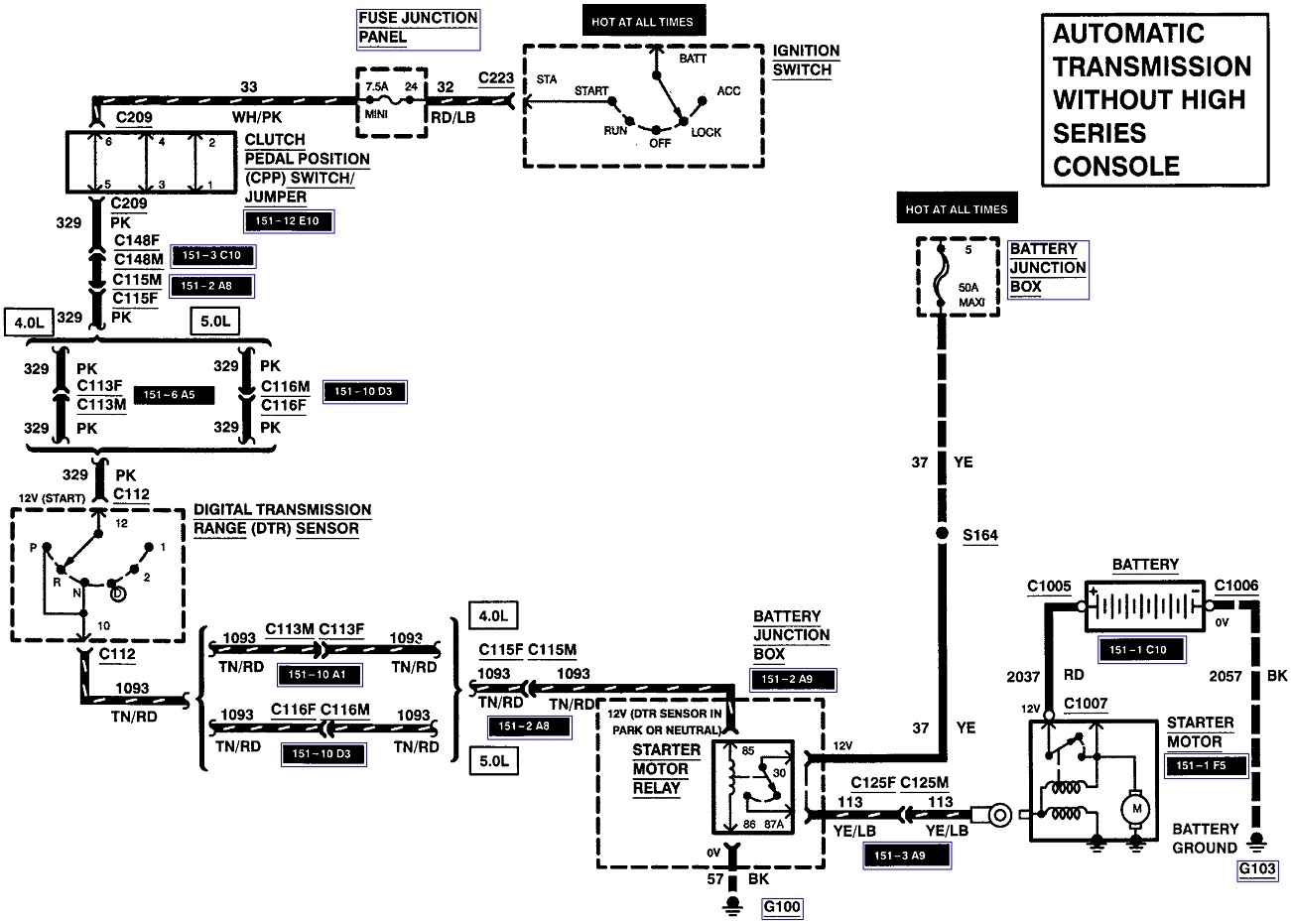

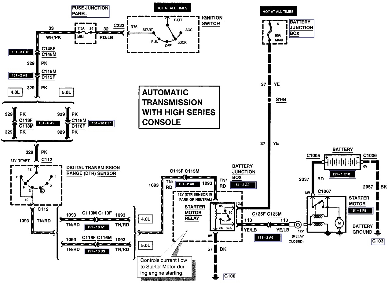

Need under the hood and inside vehicle fuse diagram won't turn over.
Dec 5, 2024 at 1:15 PM
CARADIODOC
  • 34,311 POSTS

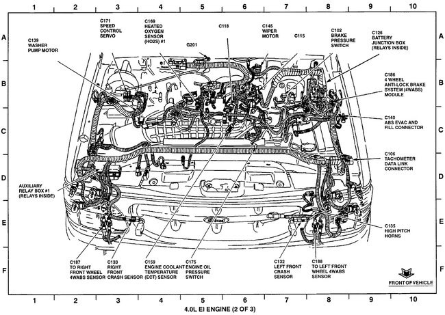

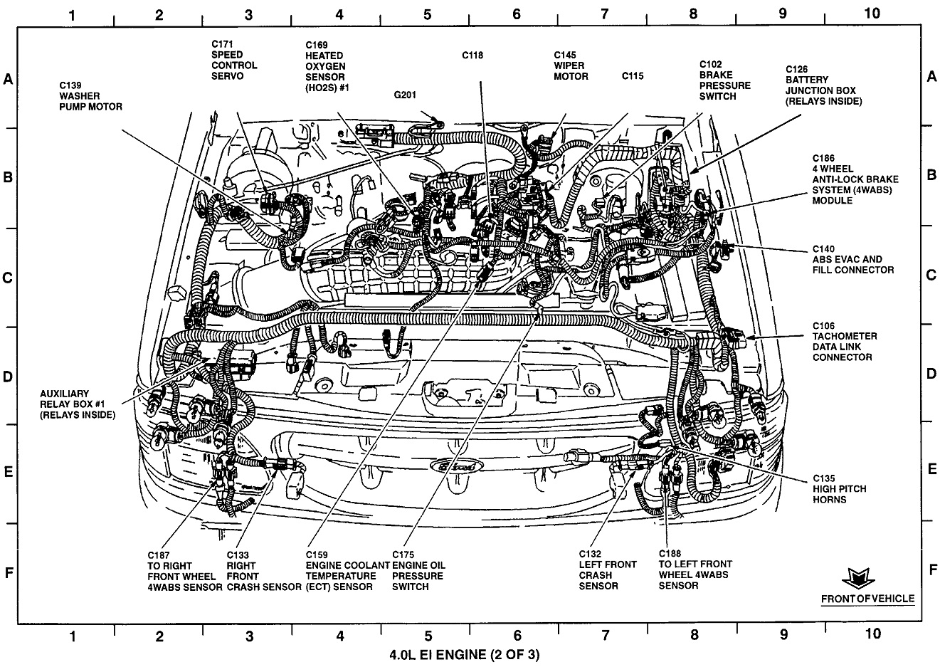

Here's the fuse box layouts. I couldn't find a drawing to show the location of the inside fuse box. I included the wiring diagrams for the starter system too if you need them.
