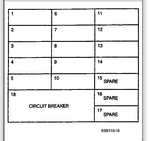

Fuse box diagram
1989 ISUZU TRUCK
89,000 MILES • 2.6L • 4 CYL • 2WD • MANUAL
PAMMIE SUE STROUD

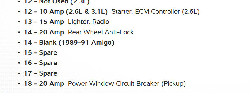

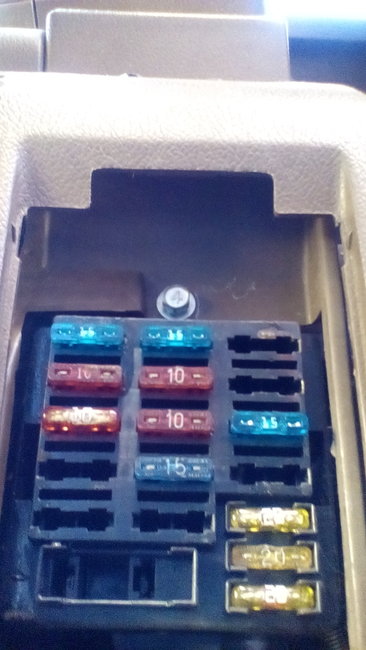

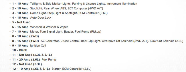

Cover to fuse box located on driver side just under the dash is gone and I need to know what size fuses, what it is for and amp . I need the diagram.
