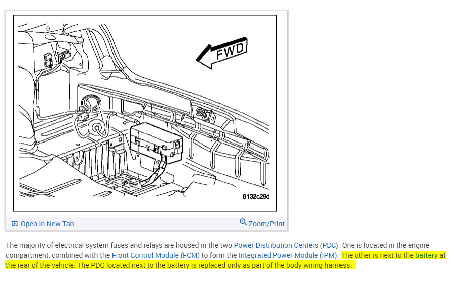

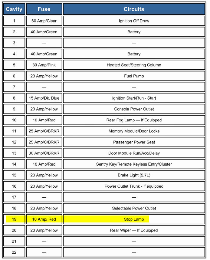

Where is the fuse for third brake light located?
Tuesday, September 17th, 2019 AT 7:40 AM
MECHANIC
18,907 POSTS

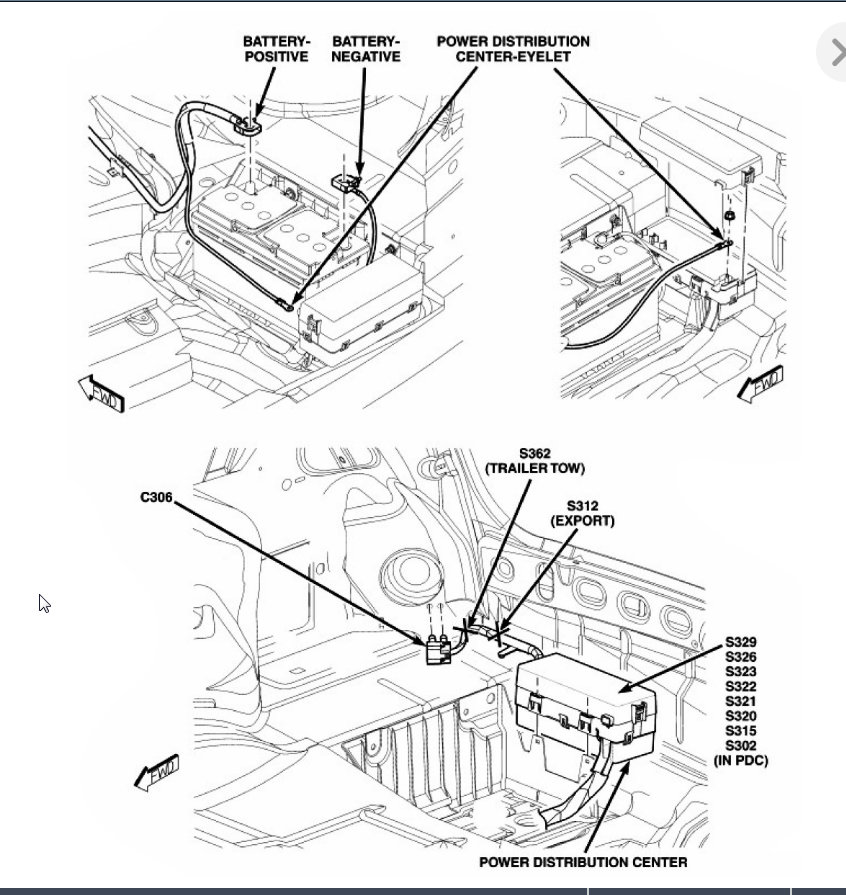

This is not solely for the third brake light but it is fuse 19 which is in the rear PDC in the trunk near the battery.
Let me know if you have more questions.
