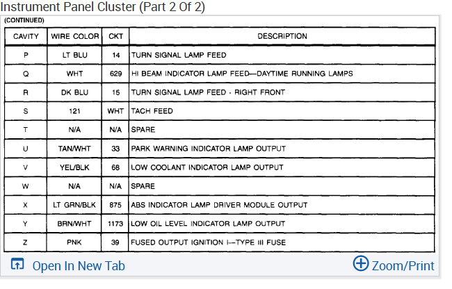

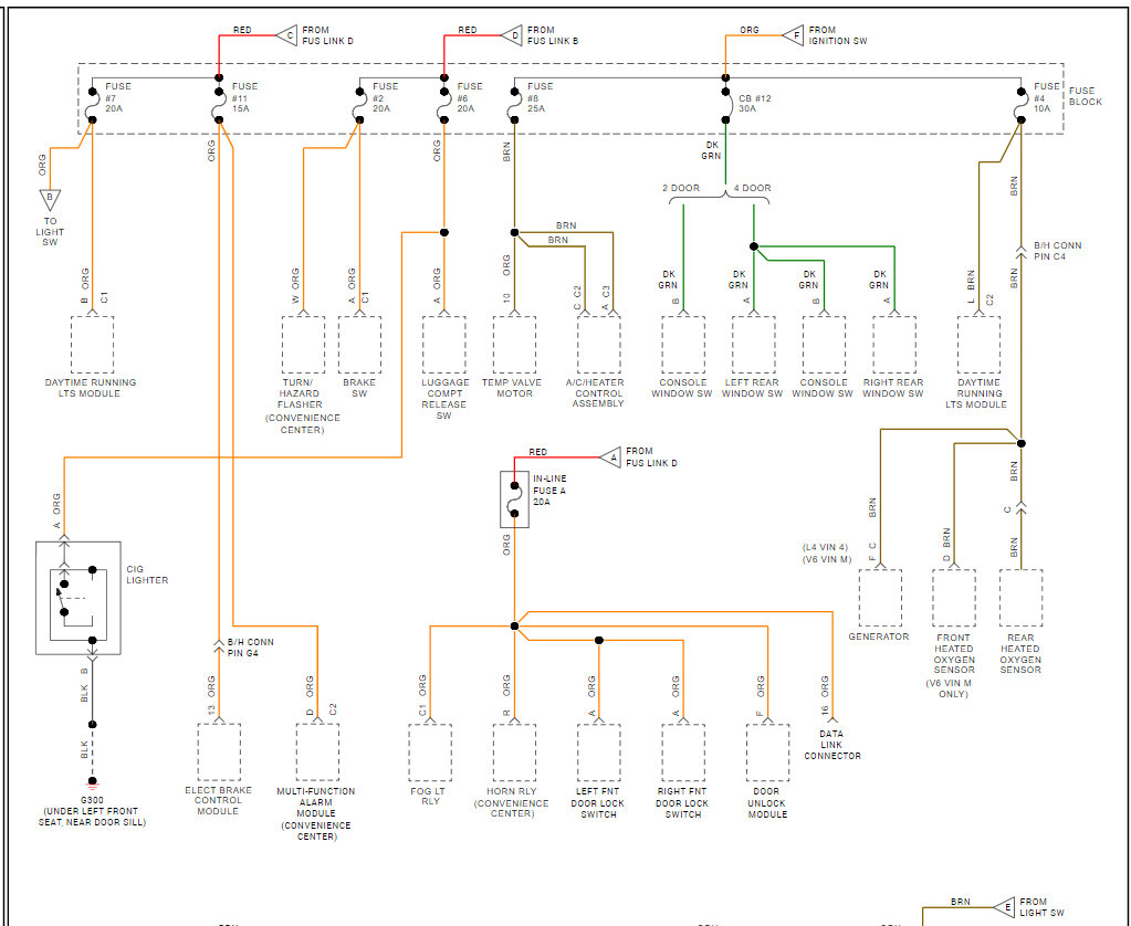

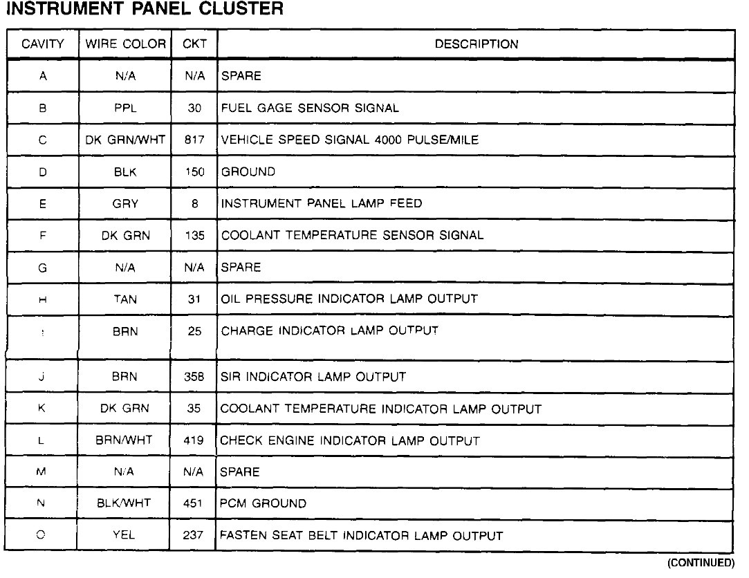

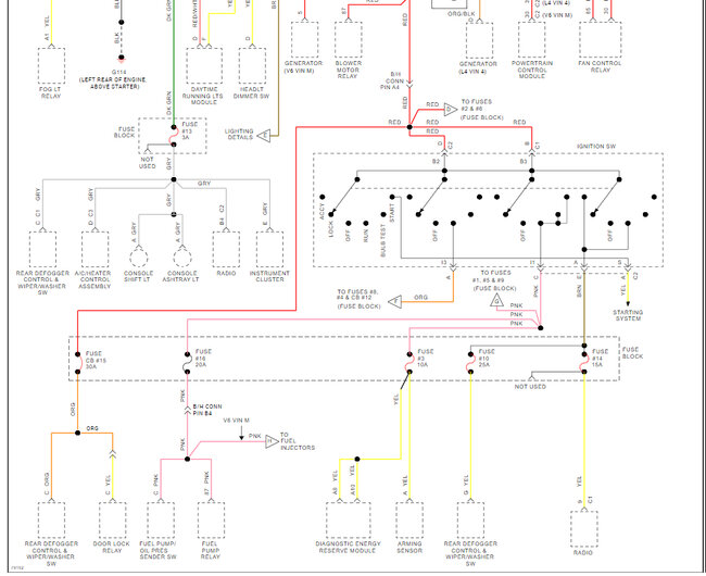

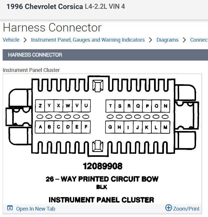

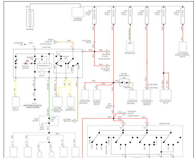

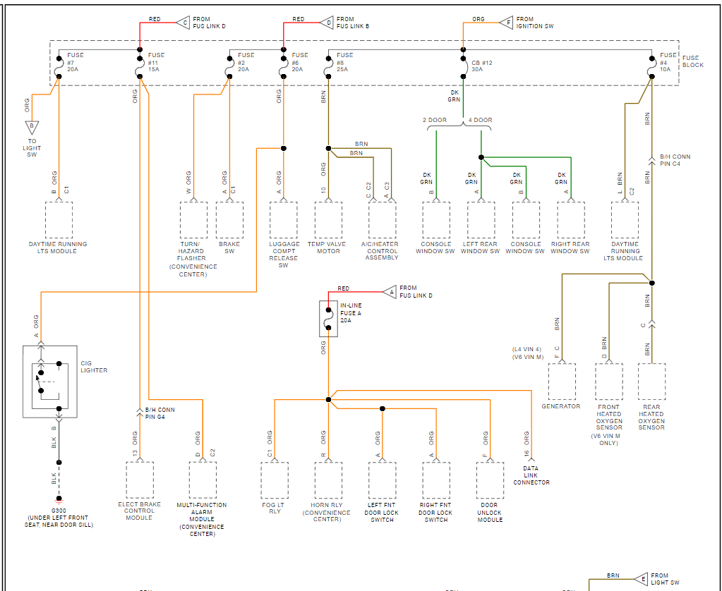

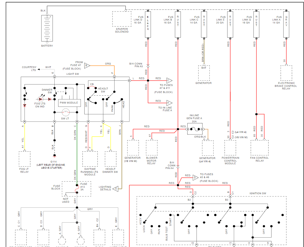

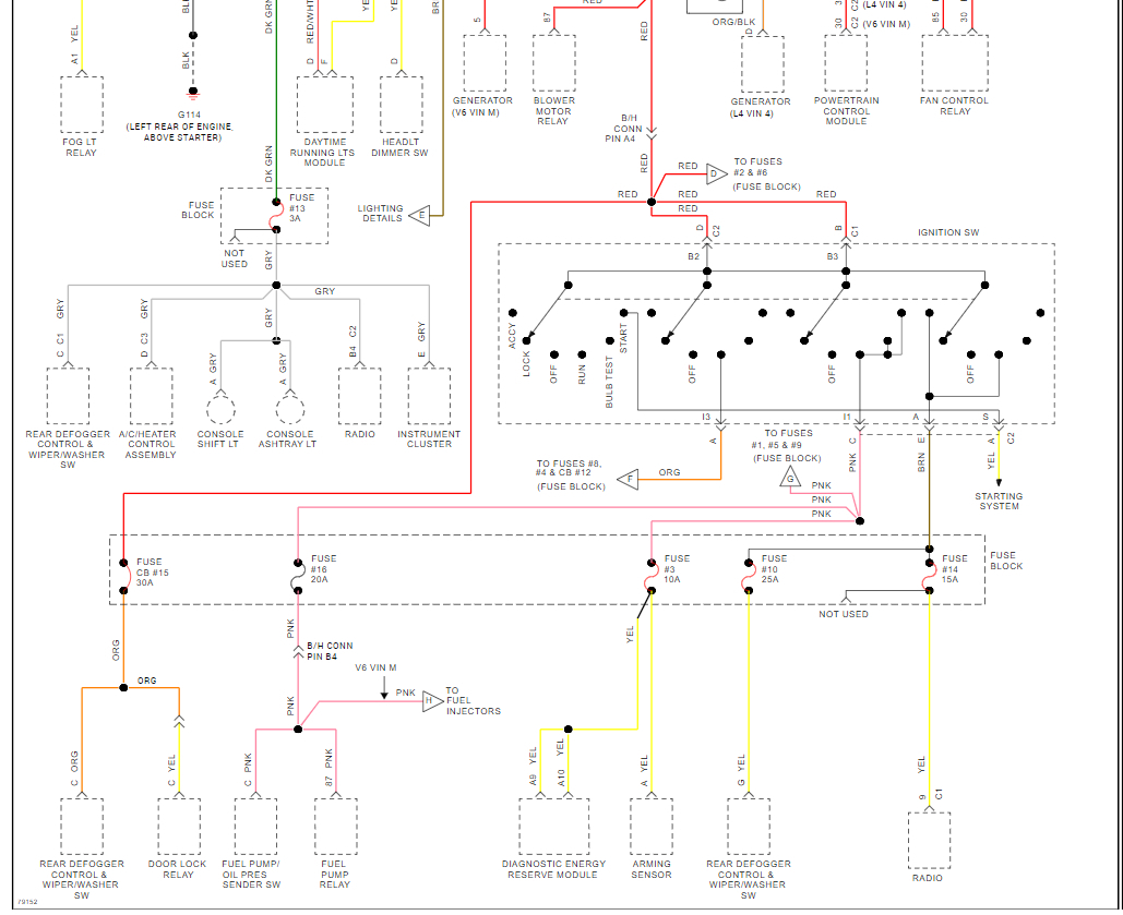

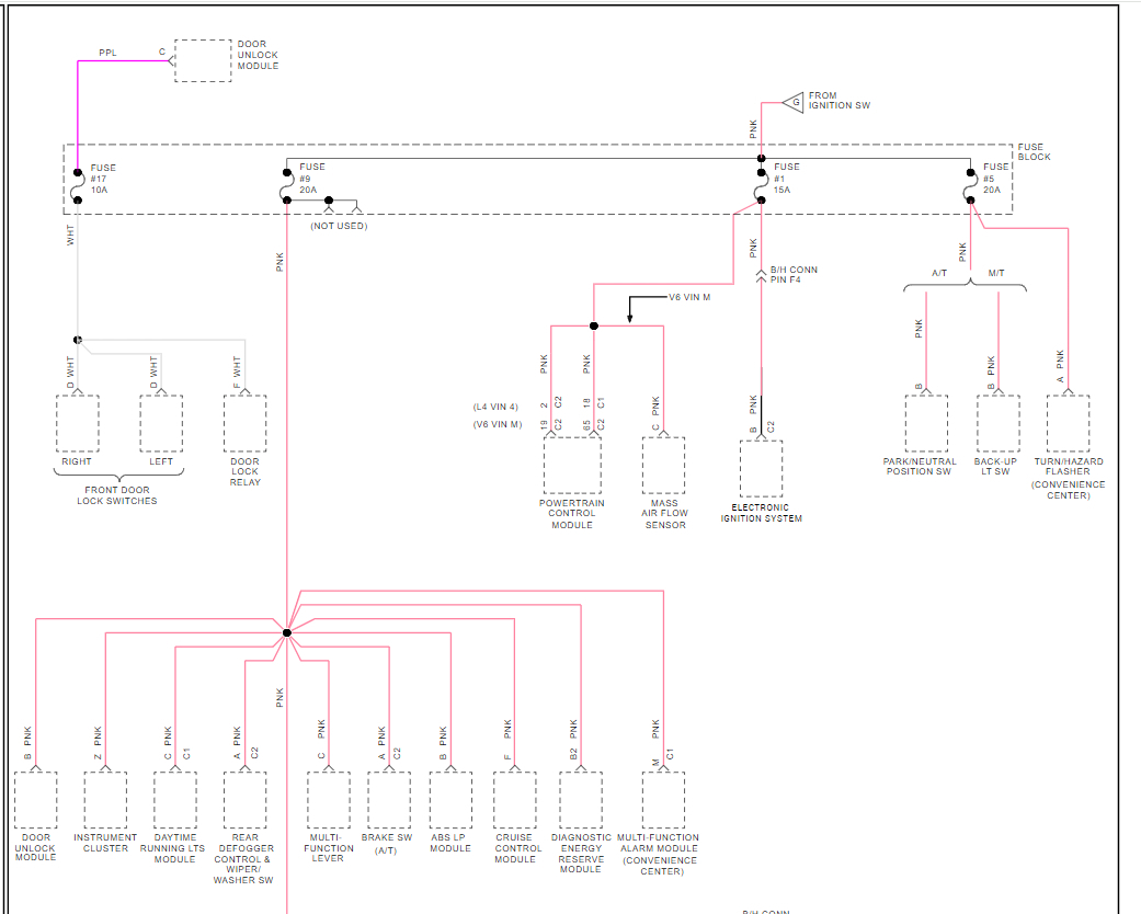

I hotwired a toggle switch without a fuse for the radiator fan and used too thin of a ground wire resulting in a fire and killed my battery, blower motor, dashboard gauges and transmission quit working because I melted down my fuse block. Now I need a wiring harness diagram, preferably color codes included, and a pinout cheat sheet I can use for my car listed above so I can wire her (Ruby) back up and get back on the road. It's been a long 9 month learning journey.
Aug 22, 2024 at 6:09 AM
  • 54,840 POSTS

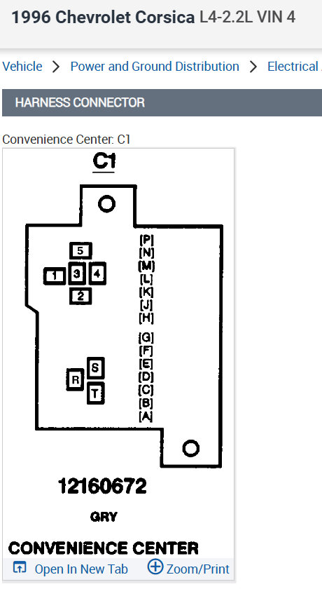

"Ruby" is a great name for a car btw :) Sorry to hear about the fire. There are no connector views for the fuse panel because the wiring just comes out of it, here are the wiring diagrams though. Check out the images (below). Please upload pictures or videos in your response of any problems so we can see what to help you with.
Aug 22, 2024 at 10:46 AM

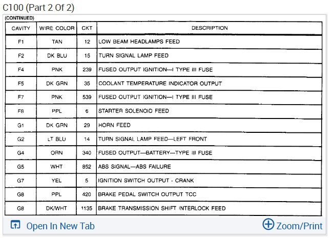

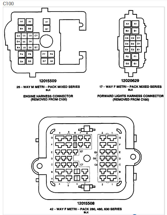

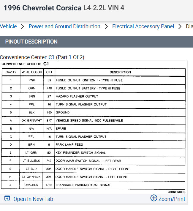

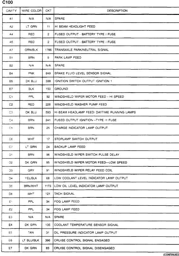

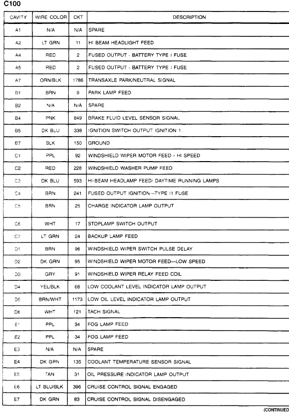

Well , I've since got my hands on Chilton's Auto Repair Guide for Ruby . However being a novice at this and working with a shoestring budget progress is slow. Down to figuring out what guage of wire to what circuit. Need to get my order ready for MetriPack 1 mixed series black 42 way Aptiv Delphi 280/480/630 male end blade terminals... Is there anyway you would have the fuseblock C100 connector/joiner ( engine bay to cabin ) pinout diagram? I am also trying to figure out how to read the junction block itself...ABCDEFG up and down / 2 , 1 17 terminals Engine junction connector and the 25 terminal Headlamp connector left to right 4,5,6,7,8 ...Do you have a diagram of proper running sequence. Also a color coded wire diagram for the 42way C100 connector junction box terminals go. Anything helps! Thank you for you time,expertise and professionalism in helping me resurrect Ruby and spin out and kick gravel in the face of all the scoffers and unbelievers who says " call the junkyard, time to scrap her!. Nonsense ! My 1996 Chevy Corsica 2.2L ,automatic, 4door sedan is my dream car. Kinda like Christine was to Arnie Cunningham, just not evil like she was. Here's the VIN if it will help you any 1GILD554XTY248314 GM

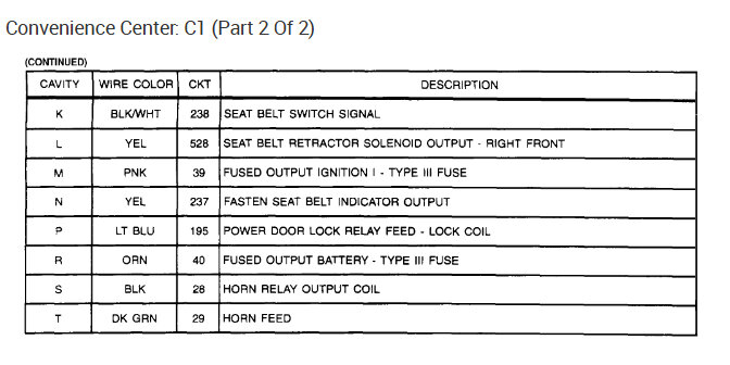

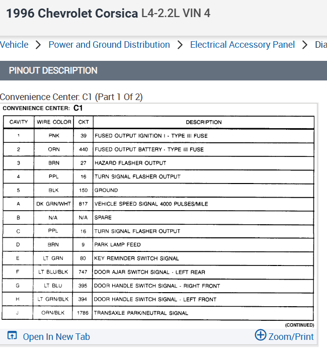

Hello Trent and Ruby! Yep, I like showing people you can make anything happen. Here is the c100 pinout as requested and I added a couple more which I think can help, let's fix Ruby! Check out the images (below). Please upload pictures or videos in your response of any problems so we can see what to help you with.
Nov 14, 2024 at 10:23 AM
BMJTHE3RD
  • 8 POSTS
Wow! A million thanks to Ken, and the entire 2CarPros team! Yes! This is exactly what I've been after! Ruby and I can never repay you for this information. We will let you know how it goes! Hopefully we will have a good report for you a little after the first of each month. Ruby is in tears over all of this! She is all but in shock because everyone has all but turned their backs on her. They will be thinking that this winter when me and Ruby ride by! New Heater Blower Motor and all!!!
