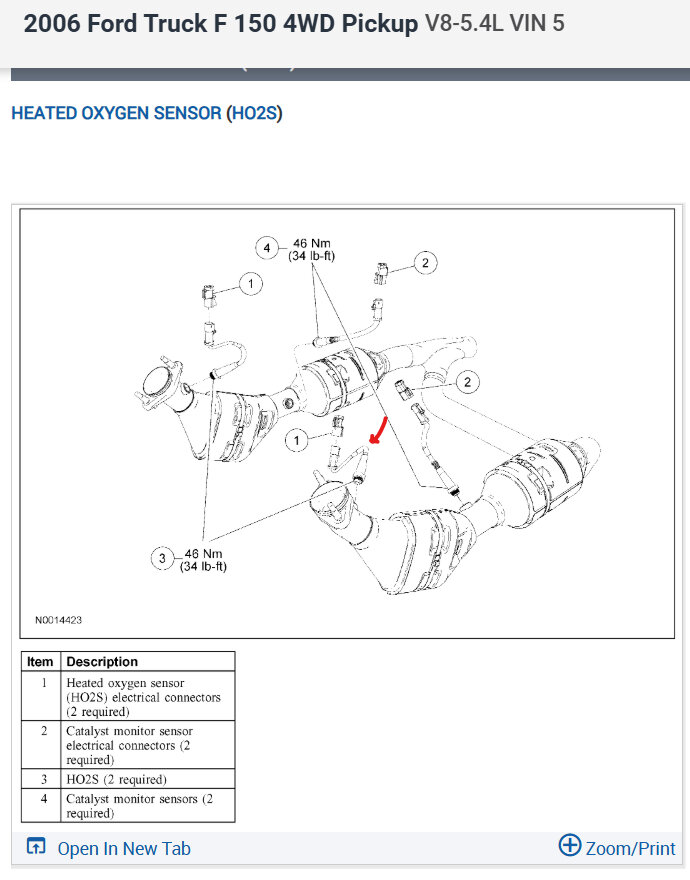

I’m trying to find out why the engine control fuse keeps blowing. It cranks but doesn’t start. I sprayed ether in the intake, and it will try to start so it’s a fuel issue too. I found a burnt o2 sensor wire on the upstream driver side. Could that cause the issue?

Yes, the oxygen sensor gets 12 volts for the internal heater so if the wires are melted this can cause the issue. Are you sure it is not fuse 32 that is blowing? This is the fuse to power the oxygen sensor. There is a fuse #22 but is it for the radio and door locks. I would replace the sensor/wiring. Check out the images (below). Let us know what you find.
