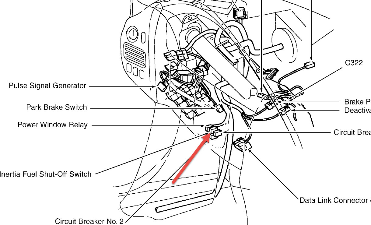

Need a picture of all fuse boxes/fuel pump.

Check to see if inertia switch is engaged and check relay and fuse in under hood fuse box. They should be marked on box or under side of top.
Image (Click to make bigger)
