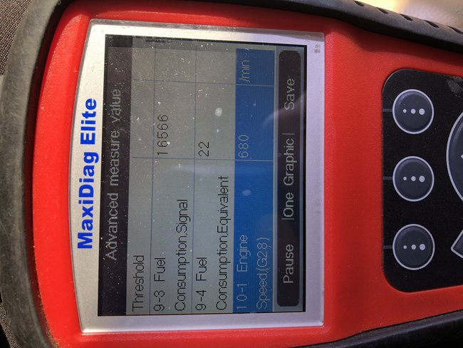

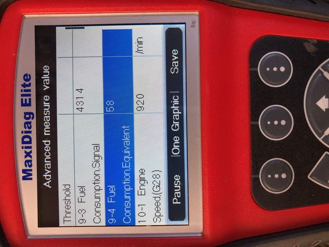

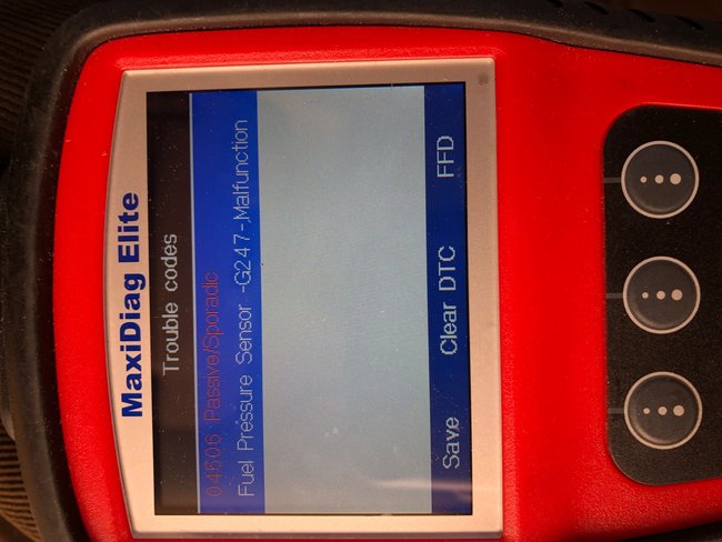

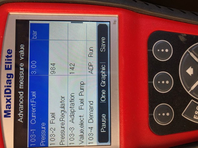

I have a rough cold idle and then gets somewhat better when warm but no driving related issues.. I have this code and I included some readings. can you see anything odd in any of the readings?
Mar 19, 2020 at 3:20 PM
  • CAR REPAIR CONTRIBUTOR

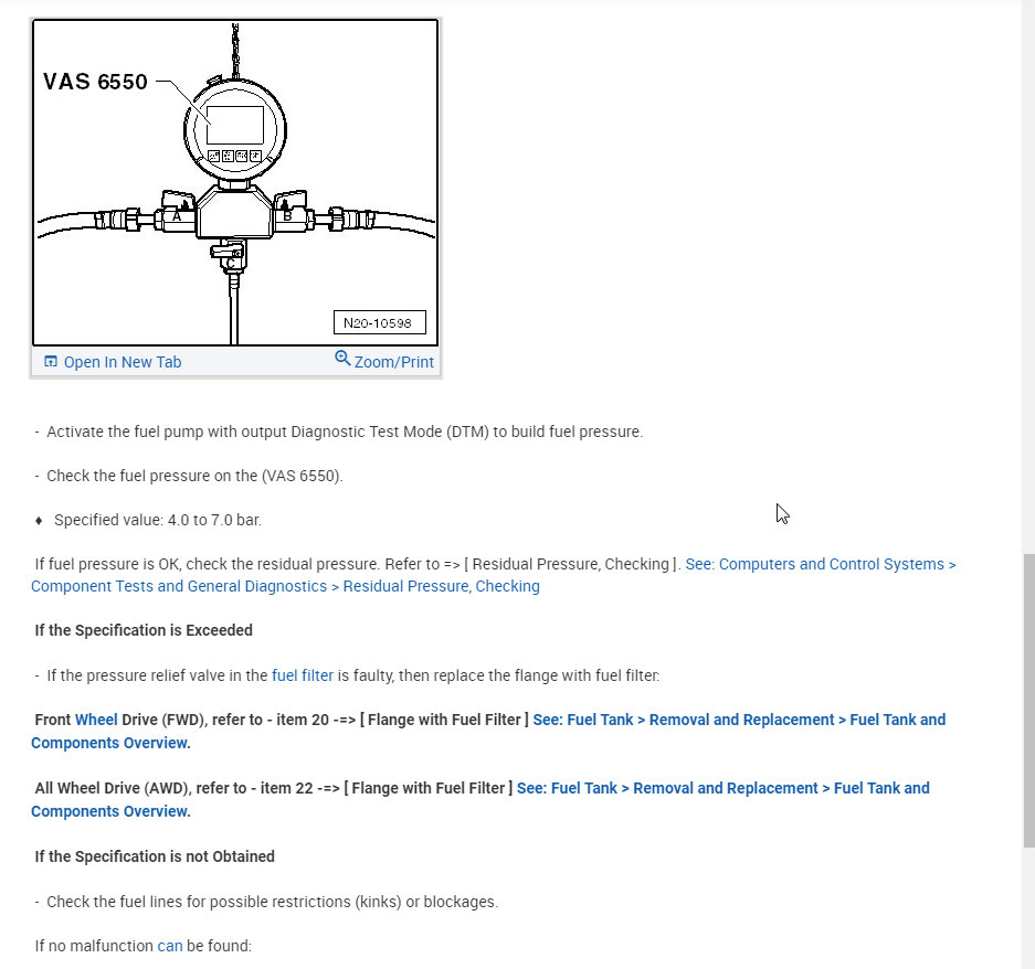

Yeah. Your fuel pressure is low. Spec is 6 bar at key on which is 87 PSI. You are at 3 bar which is 43 PSI. This is assume you have the 3.6L engine. Do you have the turbo engine?
The fact that you have a code for the sensor, could just be a faulty reading but the fact that you have cold idle issues, points to a mechanical issue which low pressure would make sense.
Let me know what engine you have and we can go from there.

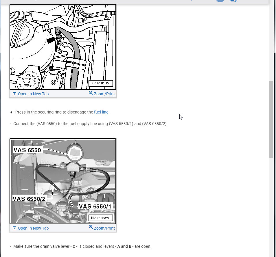

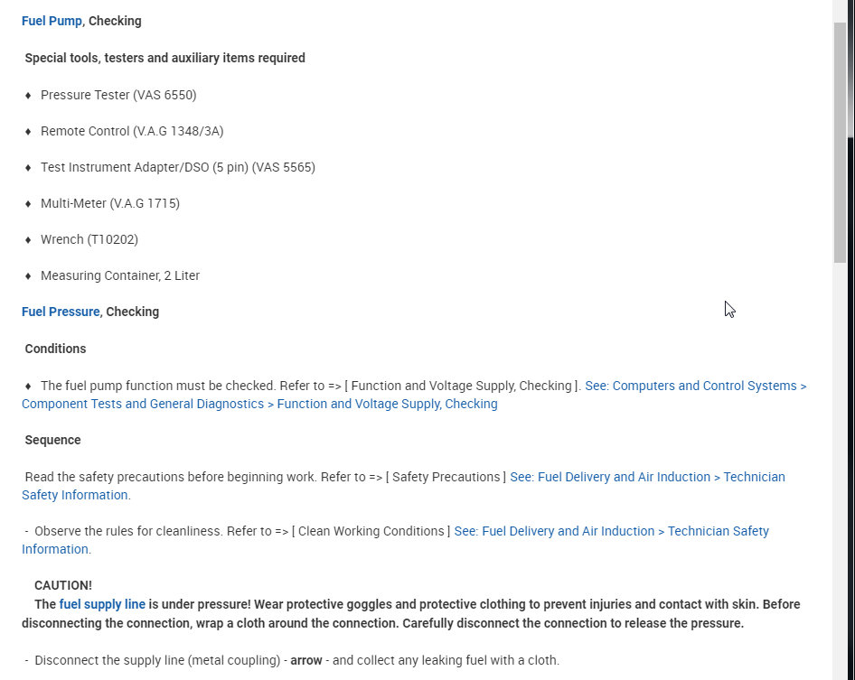

Where is the fuel gauge connector on this engine?
Mar 20, 2020 at 1:49 PM
I copied it but never attached it. Sorry. Here is the process. It calls for special tools but it is not required.
Mar 20, 2020 at 1:55 PM
NASER NASER
  • 836 POSTS
So there is no traditional nipple? i got to remove the hose from the connector?

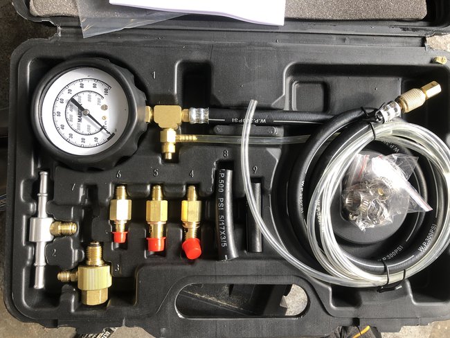

I have this kit would it work?
Mar 20, 2020 at 2:32 PM
The gauge is fine. The only thing I don't know if the adapter for the engine. That kit should come with an application chart for each fitting. If it doesn't, do they include a call center? I have numerous tools that I have called and they are able to tell me which fittings apply to each vehicle.
I tried to cross reference the adapter number from the procedure but it doesn't pull anything. I would see if one fits on and if not, just see if you can call the company for an application chart.

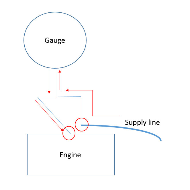

You are correct. Sorry, I didn't look at the process that closely. At that point all you need to do is splice this gauge in the supply line. This kit may not have what you need to do this but I am sure any parts store will have a selection of fuel line fittings that you can make it using the fittings and then just rubber fuel line.
Does this make sense? If not I can try to make a diagram/drawing of what the set up will look like.
They are proud of their engineering ability and it shows here because a schrader valve is too easy.
You would need to find fittings that fit on the line and engine port. Take a look at the drawing. This is clearly just a rough idea of what it needs to do. The fuel pressure just needs to go through the gauge anyway it can.
Unfortunately there is no other way of confirming the sensor is accurate. The only option I think we have to to replace the sensor and see if it is any different. If it is then clearly that was the issue. If not then we have weak pressure. Clearly not desirable.

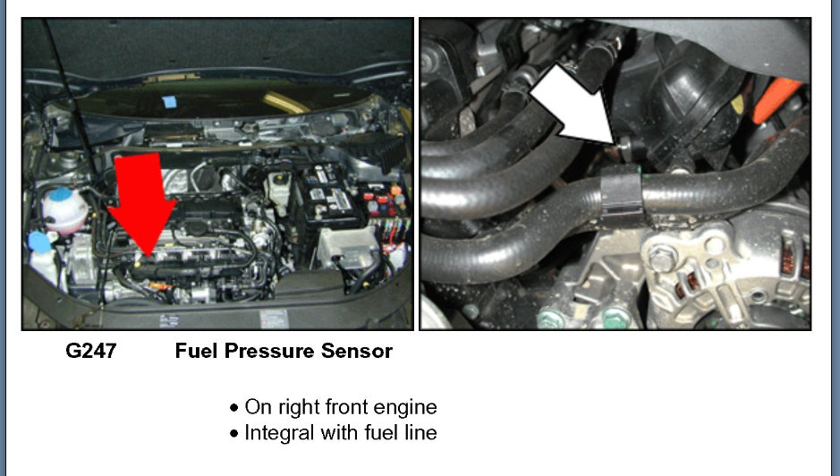

I see one that looks like it, but online it says that some of them are on top of the fuel pump.and some on the HPFP.
Mar 20, 2020 at 3:52 PM

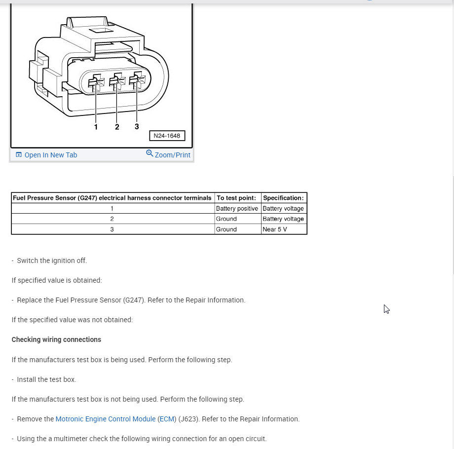

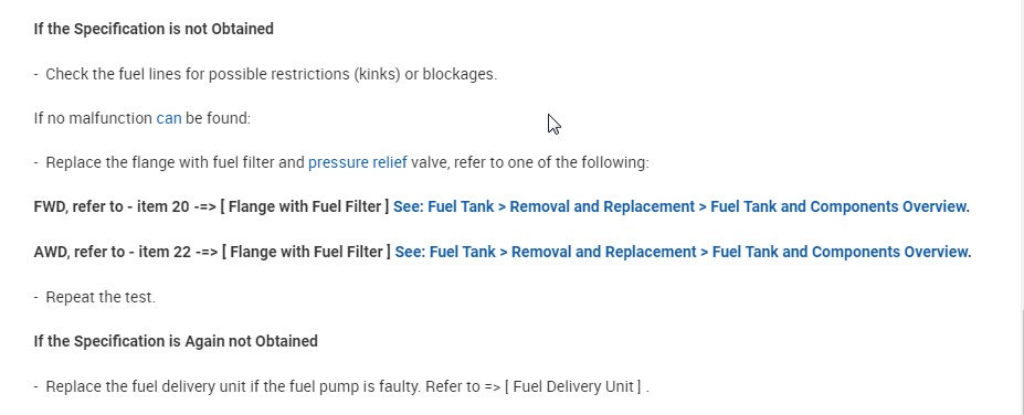

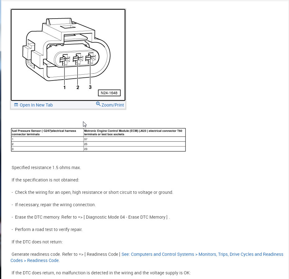

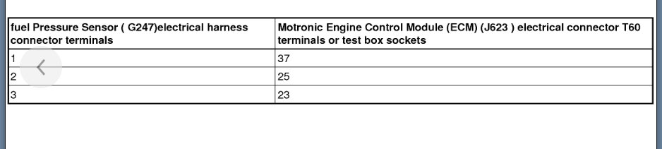

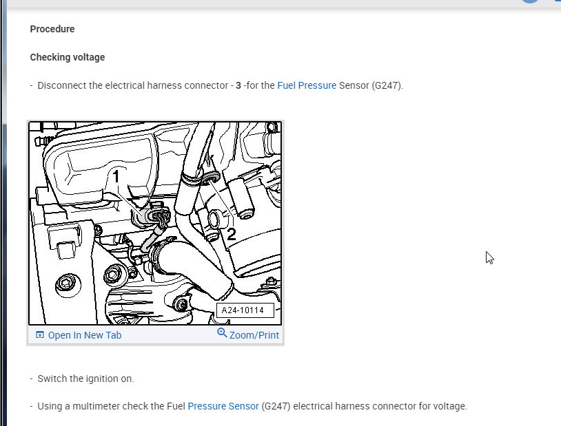

Yes It is. I just checked to see if there was a test for the sensor itself and surprisingly enough there was. This may not be easier then just replacing it but may be worth a try.
Mar 20, 2020 at 3:53 PM

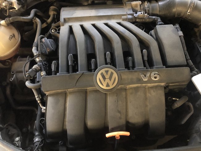

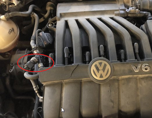

NASER NASER
  • 836 POSTS

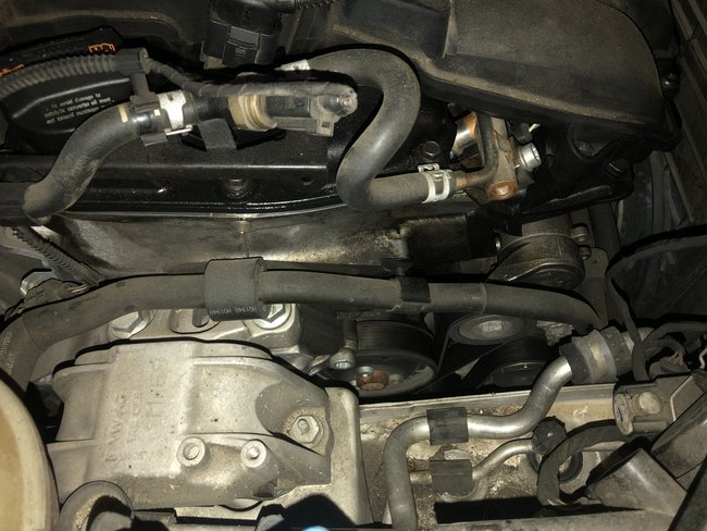

On right side of picture.
Mar 20, 2020 at 3:55 PM
NASER NASER
  • 836 POSTS
I don't see the same picture as the one you attached, not sure what am looking at is it by end of the valve cover close to the engine oil fill cap or under the intake?
Mar 20, 2020 at 3:59 PM
This should help. Let me know if you still can't find and I will see what else I can get.
Mar 20, 2020 at 4:01 PM

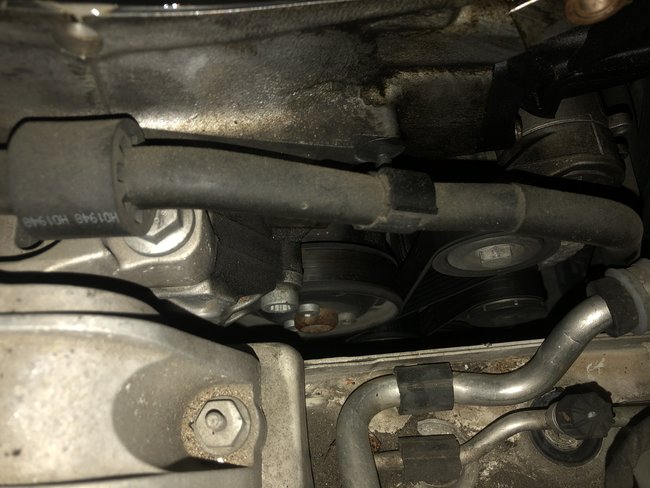

NASER NASER
  • 836 POSTS

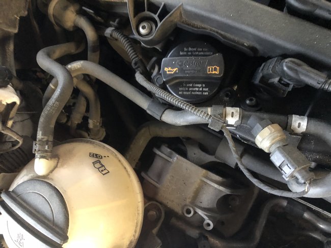

I don't think this is the same as mine. Check out my pictures.
Mar 20, 2020 at 4:20 PM
Looks like this is the fuel supply line so this sensor in the fuel line should be it. Easiest way is to unplug it and then check codes with the key on. You should have an active code for the sensor.
Mar 20, 2020 at 4:36 PM

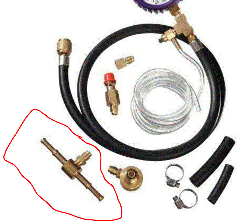

  • 110,190 POSTS

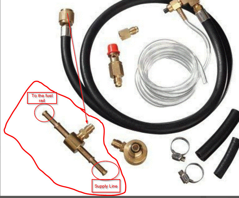

Hi again. Hay, I attached a picture of the T for testing pressure when they don't have a schrader valve. You should be able to get one anywhere.
Take care.
Mar 20, 2020 at 8:21 PM
NASER NASER
  • 836 POSTS
I have that, but how do i test it?
Mar 21, 2020 at 5:58 AM
If you have that then you will need still need to find two fittings to make it work. One that goes into the actual fuel supply line and then just connect it to the one side of the T fitting. Then the other side that goes from the T fitting back to the rail where you will need the other fitting to go on the rail. The the gauge just threads onto the threaded part of the T fitting.
I sketched this out on Joe's picture.
Mar 21, 2020 at 7:02 AM
NASER NASER
  • 836 POSTS
So pretty much adding a sensor within the line itself, the sensor being the gauge, instead if relying in the fuel pressure sensor.
Mar 21, 2020 at 7:04 AM
Exactly. You are simply verifying the sensor is telling you the correct pressure by using a "known good sensor" which is the gauge. This way you know if you have a pressure issue or a sensor issue.

NASER NASER
  • 836 POSTS

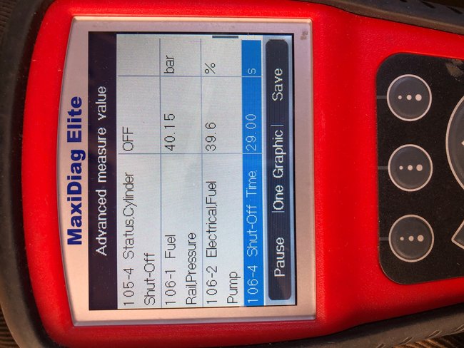

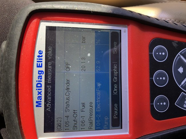

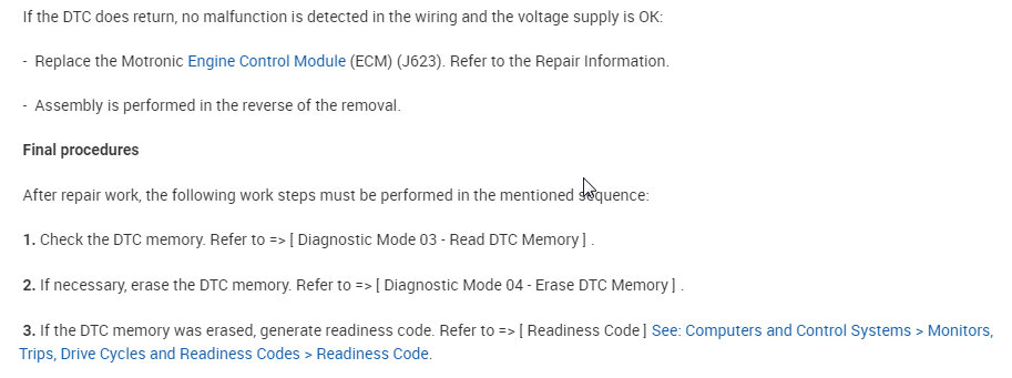

Changed the sensor on too in the rubber line, can you see any difference here?
Apr 1, 2020 at 7:47 AM
Is there an option for "current fuel pressure"? I don't see it there. Thanks
