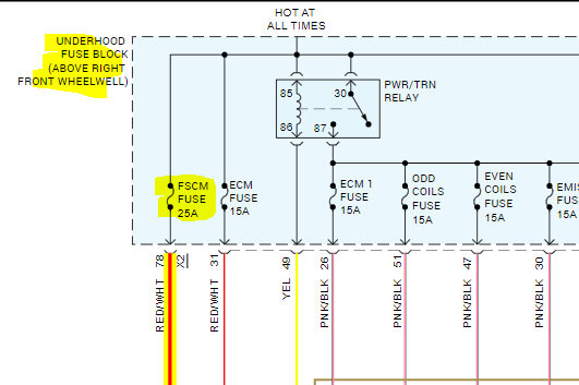

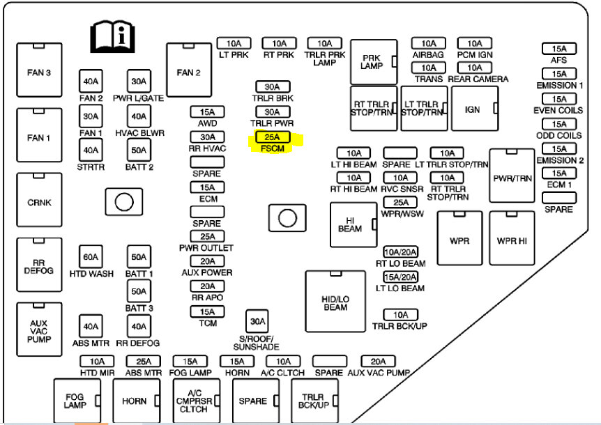

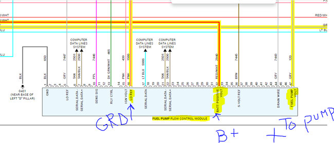

Looking for the location of the fuel pump relay and the fuse box because there is no electrical power coming from the backend of the car. The fuel pump and module tested fine. Just need location of Relay.
Sep 12, 2024 at 2:46 PM
  • CAR REPAIR CONTRIBUTOR
  • 110,190 POSTS
I attached a couple pictures from the wiring schematic. Based on the schematic, power comes from the 25a FSCM fuse in the under-hood fuse box and travels to the fuel pump flow control module. From there, power is routed to the pump and a low reference ground determines when the pump runs. There doesn't appear to be a relay.
Take a look and let me know your thoughts.
