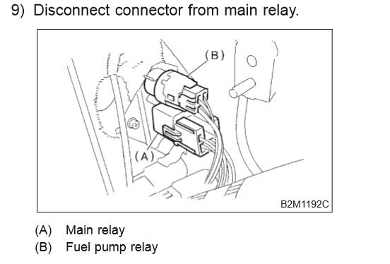

We can't seem to find where the fuel pump relay is on my car, can someone help

It's behind left side of dash we have no pic in manual but this pic is from tips page there are several there.
Image (Click to make bigger)
