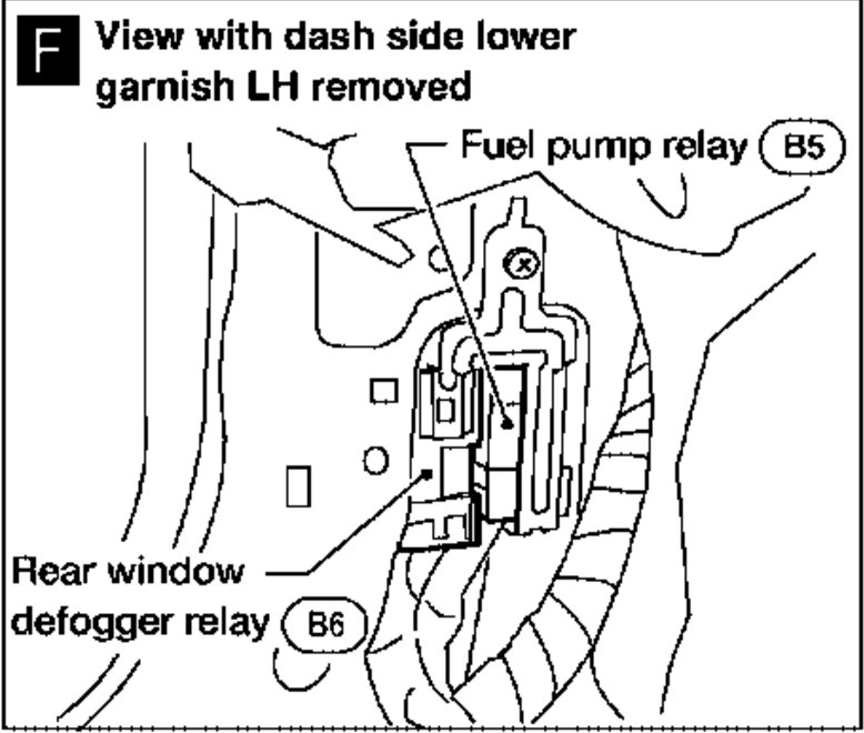

Fuel pump wont turn on. The car turns over, but wont fire. I cannot find fuel relay location.

The fuel pump relay is located behind the left kick panel.
Image (Click to make bigger)
