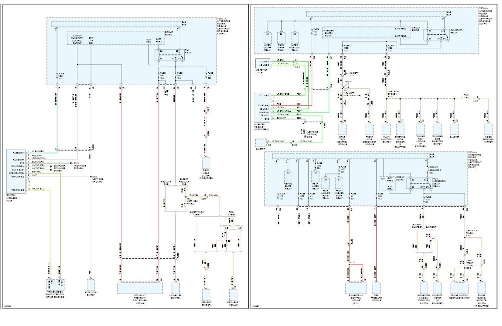

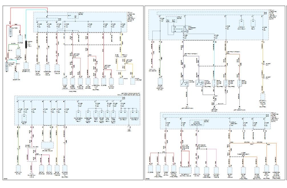

CARADIODOC
  • 34,486 POSTS
It looks as though the bus bar that feeds those fuses should only have power with key on.
See the wiring diagrams below for more information.
Sunday, October 14th, 2018 AT 4:12 PM

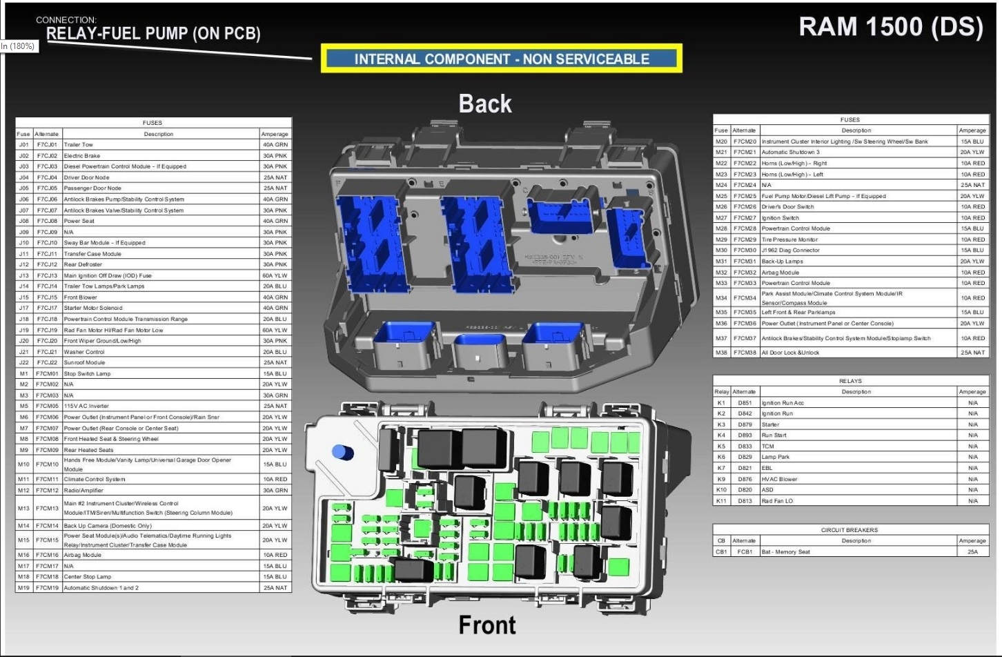

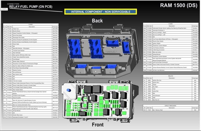

Not all the time but maybe once every twenty five starts the fuel pump continues to run after the truck is turned off. Restarting it does not help the only way to get it to shut off is to pull fuel pump fuse than you can put it back in and it will be back to normal operation until it happens again it has acted up three times now. When it is stuck on the truck can be totally off no key in ignition and the pump will run continuously.

KEN L
  • MASTER CERTIFIED MECHANIC
  • 55,450 POSTS
Hey CRAIG5820,
The fuel pump relay is integrated into the TIPM which you may be able to fix by trying the find the relay which is soldered in. Turn the key on and feel for the relay that clicks. Here is a diagram to help with the location.

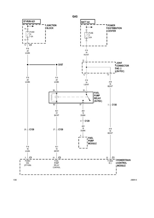

I can run a hot wire to pump and it works and I can ground the relay and it works I have 2 codes 1 is po 0443 which is perg controle valve circuit the other is po 1282 which is fuel pump relay iv replased the relay with a now good one and ran a hot wire to pump and it works I need to get truck smoged frustrated in calif

CARADIODOC
  • 34,486 POSTS
Have you checked for spark?

KEWLIAM

CARADIODOC
  • 34,486 POSTS
Rats. With the tests you've done, it does appear the computer is not grounding the fuel pump relay. It needs pulses from the crankshaft position sensor and the camshaft position sensor to do that. If one of those signals is missing, there won't be spark.
Listen for the hum of the pump for one second after turning on the ignition switch. If you hear that, the fuel pump relay is good and the computer has control of it. If you don't hear it, suspect the computer, but before you condemn it, ground the relay coil right at the computer plugs. If the relay clicks on, that will confirm that wire between the relay and computer is okay. Next, there should be four ground wires, two listed as "signal" grounds and two as "power" grounds. The best test for them is a voltage measurement while the relay is bypassed and the engine is running. If you find more than a couple of tenths of a volt, check that wire for a corroded connection to the body.

KEWLIAM
Tested all hots to computer and grounds, I grounded pin 19 at(c3) and relay worked pin 2 and pin 22 on(c1) both are hot im going to dive in and get the computer and hopping it taks care of the po1282 ill let u now what happends and thank you donation will be comming

KEWLIAM
Caradiodoc, it was the computer I ended up using a 341ae insted of a 341ac becouse thats the only used one I could find for under a 100 dollers the last letter is a upgrade! Thanks for your time I was a master teck for firestone 6 years ago un"till a chain snaped on the old alingment rack and the safty latches gave out and landed on me it broke my back owell. I dont chang parts untill its fixed, like alot of those (book smart) master tecks lol ! Like my dady told me, do it right the first time or youll have to do it again have a nice day whhoooya
