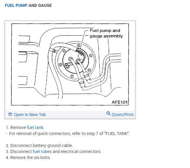

Where is the fuel pump located? is it under my backseat or do I have to go through the gas tank?
Aug 20, 2019 at 11:13 AM
CAR REPAIR CONTRIBUTOR
18,907 POSTS

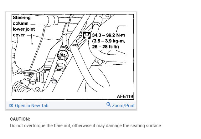

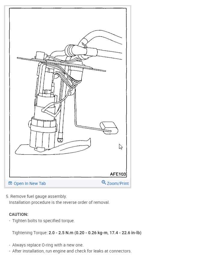

Hi Ben,
Unfortunately, you need to remove the tank. Here is the procedure for the pump. Let me know if you need more information. Check out the diagrams (Below). Please let us know if you need anything else to get the problem fixed. Thanks
Images (Click to enlarge)
