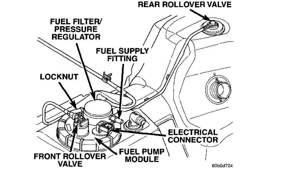

Will a universal inline fuel pump work on the truck listed above 1500 4 door truck?

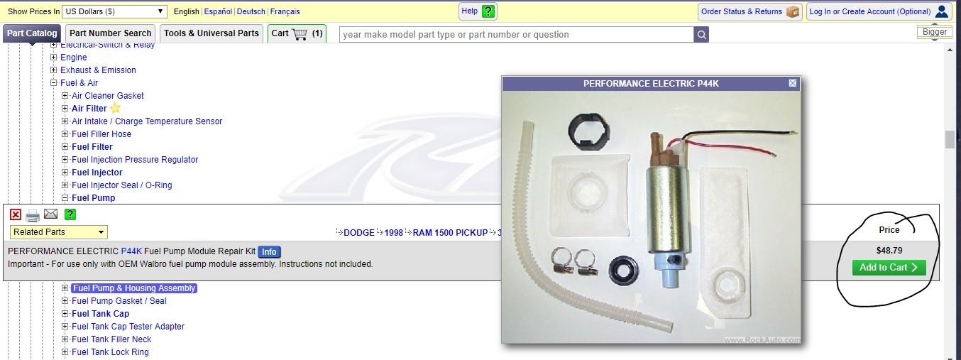

It needs to be a pump that is regulated to 50 lbs. That is what your truck requires.
Why not replace the pump in the tank?
A pump from rock auto is $48.00.

Go to there web site. Put in your truck and go to the fuel pump. They usually deliver the next day.
I attached the picture of the pump for you.
