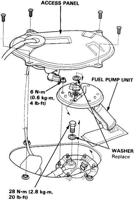

Where is the location of fuel pump?

The fuel pump on your vehicle is mounted inside the fuel tank. It is accessible through an access panel located under the rear seat. See attached picture.
Image (Click to make bigger)
