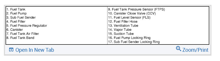

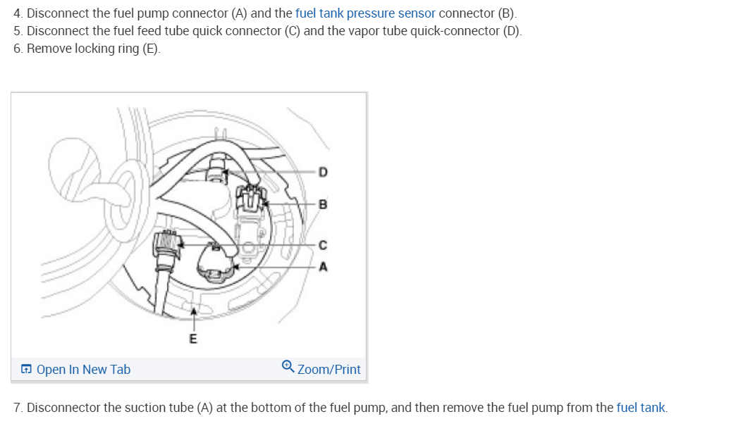

Where can I get fuel pump replacement instructions with photos?
Oct 29, 2022 at 7:29 AM
  • 54,520 POSTS

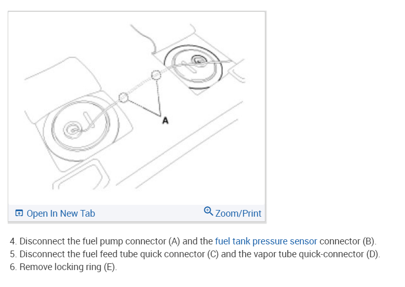

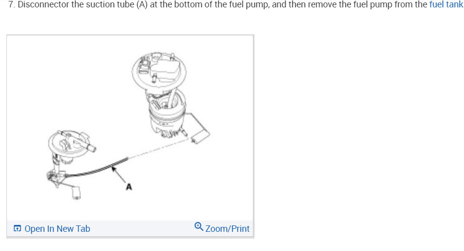

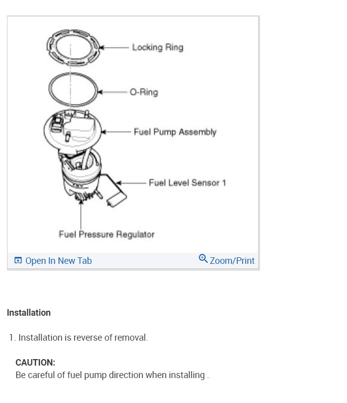

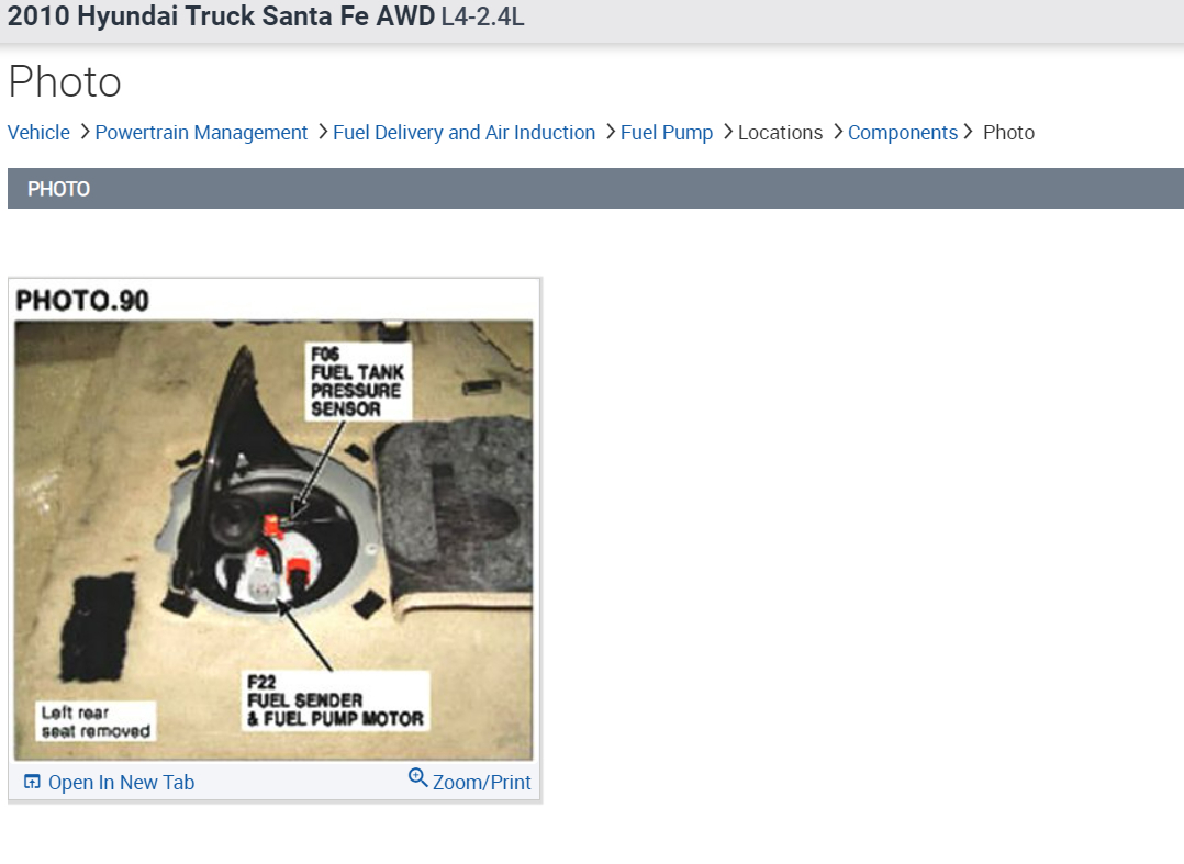

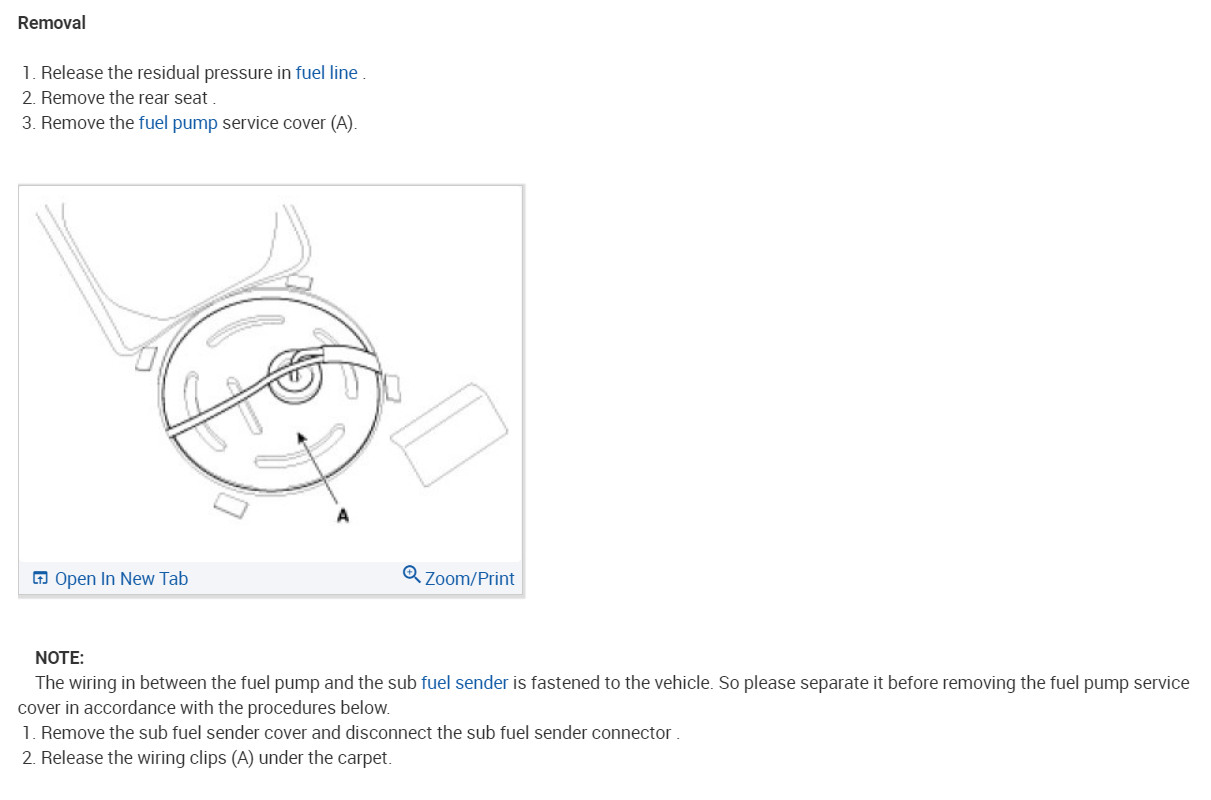

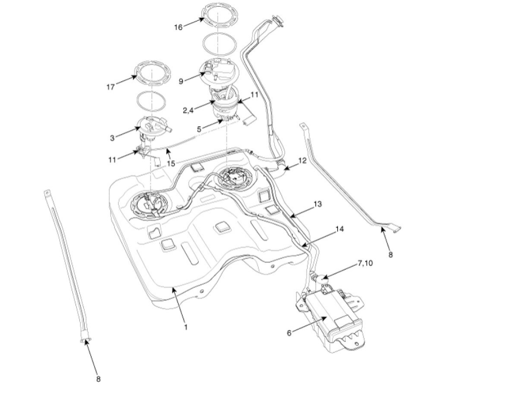

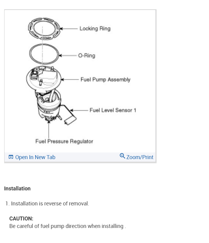

There is a trap door which is nice, so you don't need to remove the fuel tank. here is the location of the door and how to replace the fuel pump in the images below. Check out the images (below). Please let us know if you need anything else to get the problem fixed.
