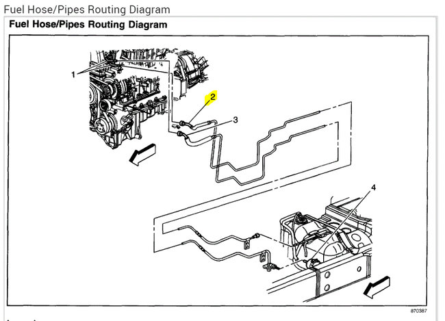

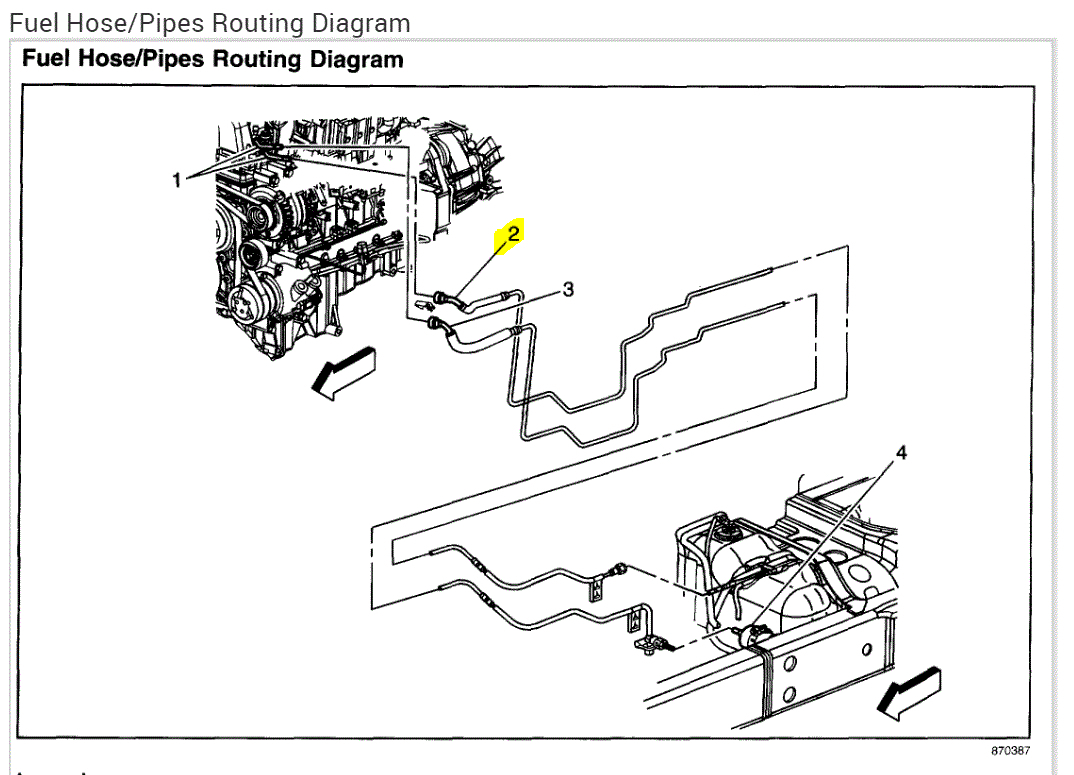

Next, the fuel system has a return line to the fuel tank. If the problem continues, I'm questioning if something has plugged the return. However, since it ran well for a few trips, I'm even questioning that. If you look at pic 1, it shows the fuel lines. The highlighted one is the return.

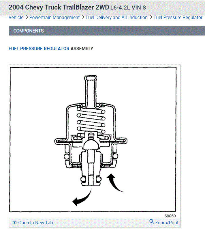

As far as the regulator is concerned, it's a very simple design. The fuel pressure regulator is a diaphragm relief valve. The diaphragm has fuel pressure on one side and regulator spring pressure on the other side. The fuel pressure regulator maintains a constant pressure across the fuel injectors under all operating conditions. If it keeps failing, either we have poorly made regulators (which may be the case), or there is extreme pressure being built that it can't handle. That doesn't make sense to me yet, but anything is possible.

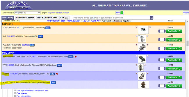

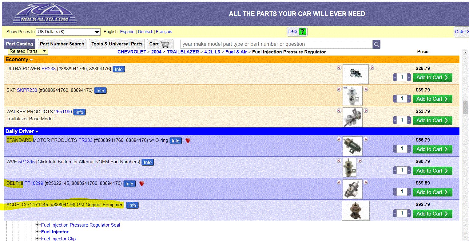

You know, I didn't realize how expensive they are for this vehicle. I did a little research for you and found a few on rockauto. Com that I recognize. I attached it in pic 3.
Let me know what I can do to help.

As far as the pressure, if it has no escape, it will build. The system has a return built into it.
The fuel pump sends pressure to the injector rail. The regulator is supposed to release the pressure when it reaches a specific point, allowing the unused fuel to return to the fuel tank. If there is no place for it to go because the return is plugged, the regulator can't do its job simply because there is no place to release the fuel. So, it will continue building until it "potentially" break the regulator.
If the new regulator doesn't help, we need to disconnect the regulator, open the fuel tank cap, and see if you can blow compressed air (low psi) through it confirming it isn't plugged. If it is, it will require the removal of the return line for inspection and to locate where the problem exists.
