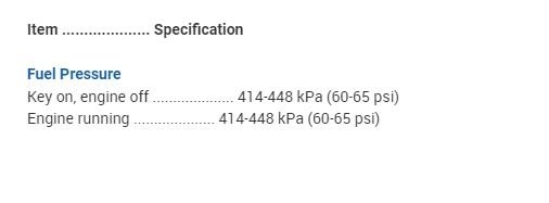

What should fuel pressure be at the fuel rail? Would like koeo and while idling please and thanks.

Good afternoon,
I attached the specs for you to view.

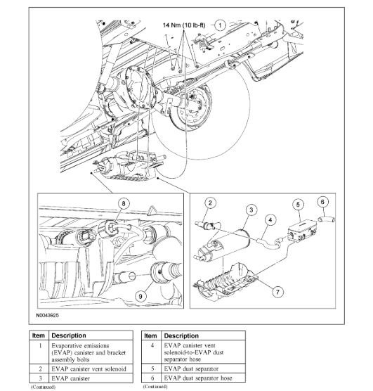

About two weeks ago I filled my truck up with gas an when I went to start it, it started real rough idle wouldn't go over 500 and it bogged out and shut off. Started it again did the same thing so I gave it a little gas and it stayed started. Didn't have another problem until I filled up again and it did the same thing so I thought maybe I was just over filling it cause I always top it off to the nearest half dollar or dollar. So I stopped topping it off thinking maybe it was maybe backing up with fumes or something. Haven't had it do it since until today. It started right up,I drove up the street a couple blocks to the post office shut it off an when I came back out to start it again it did it. I haven't done a fuel pressure check yet but I did get under and listen to the fuel pump and it sounds fine. No whining from it or loss of power while driving or anything. It's just random on a couple start ups. Was wondering if you had any ideas on what it could be?

It could also be the charcoal canister at the rear of the truck. It gets filled with fuel from filling up and floods the engine.
Are there any codes set?

No to the filter or regulator. It would do it all the time.
The canister I told you about is for the evap system which is all about fuel vapors.

I would check and see if there is any fuel in the canister.

No, it is sealed. You can remove it and turn it upside down and see if fuel comes out?
