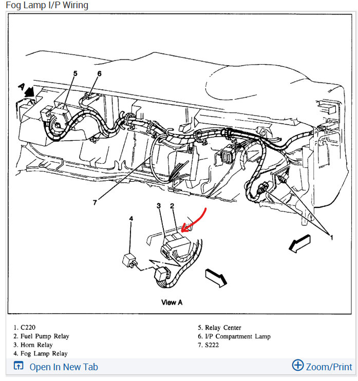

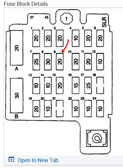

Replaced the fuel pump still no fuel pressure. Truck will not start.

If you cannot hear the fuel pump come on in the tank after turning the key on the fuel pump is bad or defective, also I would try checking the fuse 9 (ECM Batt) and swap out the fuel pump relay, here is the locations for both. Check out the images (below). Let us know how it goes.
