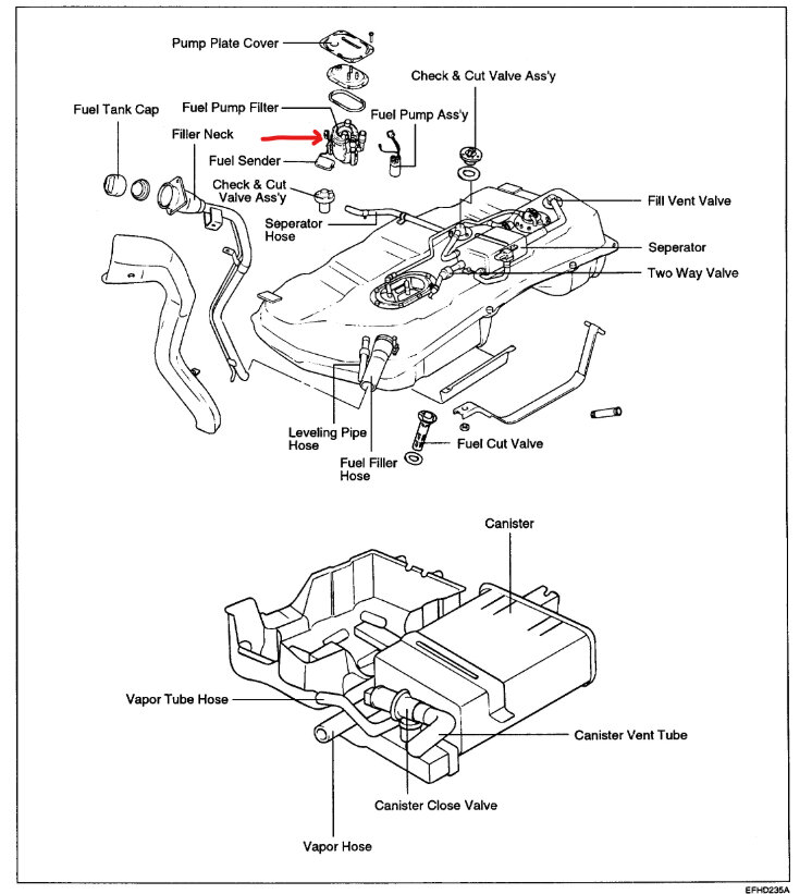

Dears,
I went with my car to the mechanics to change the fuel gauge because on the instrument board the fuel level was at the first level, but the tank was empty (and I remained without fuel :)). I think changing the instrument board, I don't know if is a good idea? Thank you for your support.

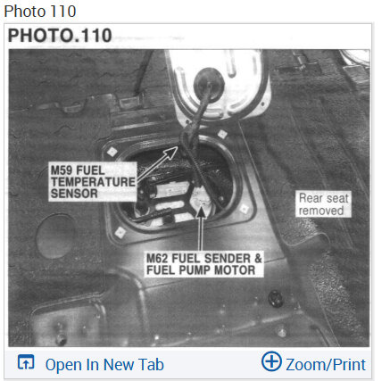

9 times out of 10 the problem will be the fuel level sender inside the fuel tank. Here is how to change it out. Luckily the car has a trap door to aid in the replacement. Check out the images (below). Let us know how it goes.
