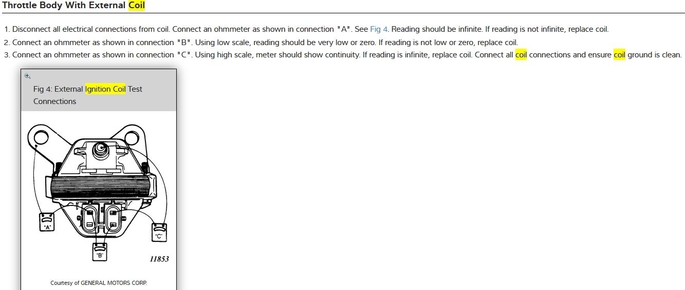

The regulator is inside the throttle body but if you say you did all 3 fuel pressure tests and they were fine and you have a new fuel filter then I would look at a possible weak spark or failing ignition module. Coil test posted below.
Also you said the TPS tested good but you said nothing about the other tests I posted. What were the measurements for them?
Them being, test for a 5 volt reference on the TPS and the ignition module.
