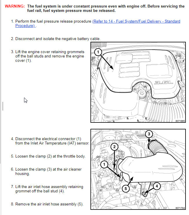

Where to find fuel injector wires?
Wednesday, July 31st, 2019 AT 1:42 PM
MECHANIC
18,907 POSTS
Hi Crenshaw,

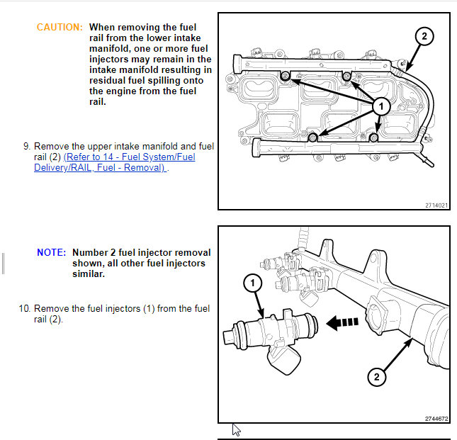

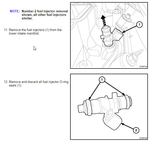

Do you mean you can't see the wires? If so, here is the procedure on how to remove the injectors. Clearly this will get you to the wiring.
Let me know if you needed something different. Thanks
