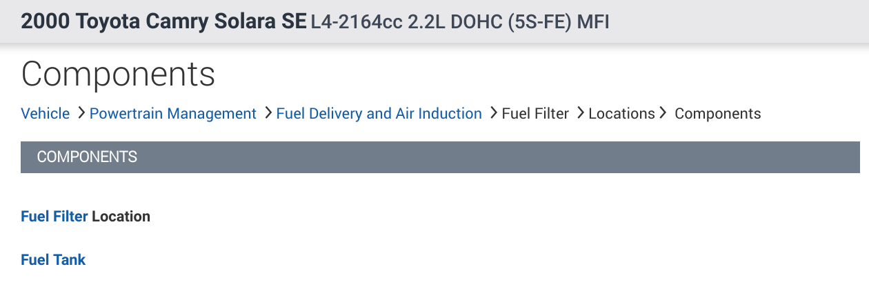

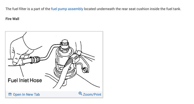

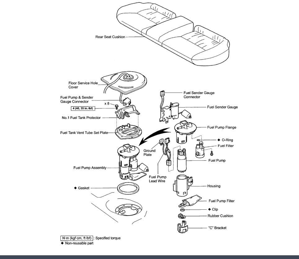

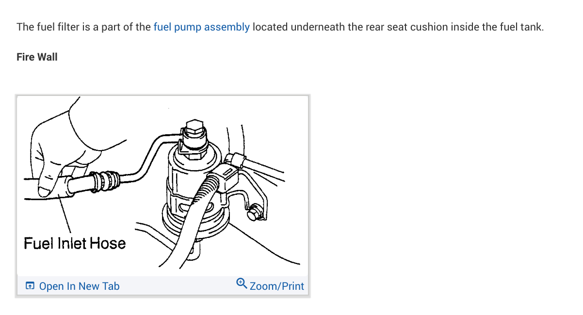

I am having trouble finding the fuel filter.
Thursday, November 28th, 2019 AT 8:14 AM
SCGRANTURISMO
MECHANIC
4,897 POSTS
The fuel filter is an integral part of the fuel pump, which is located in the fuel tank. In the diagrams down below I have included an exploded diagram of the fuel tank/fuel pump/fuel filter assembly for you. I hope this helps.
