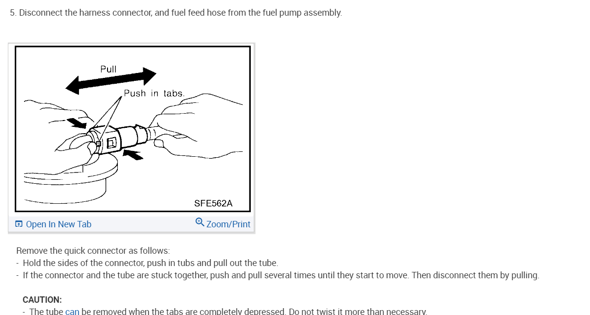

Where is the fuel filter located?

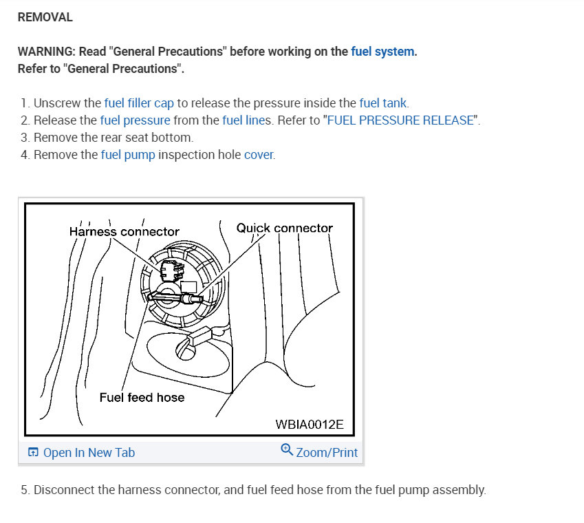

Can't find fuel filter?

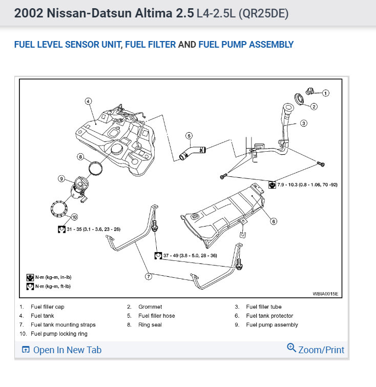

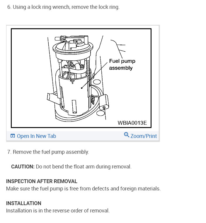

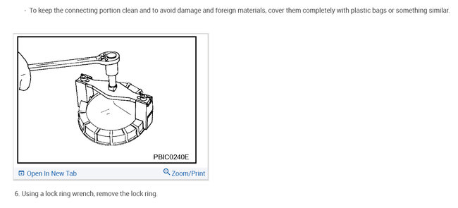

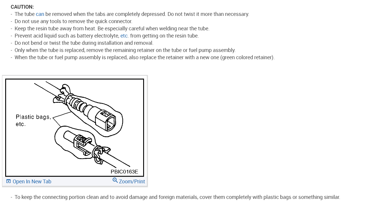

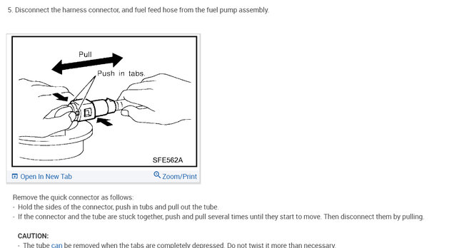

The fuel filter for this car is in the fuel tank and the fuel pump must be removed to change it out. Here are the instructions to do so in the images below. Let me know if you need anything else, we are here to help.
Images (Click to make bigger)
