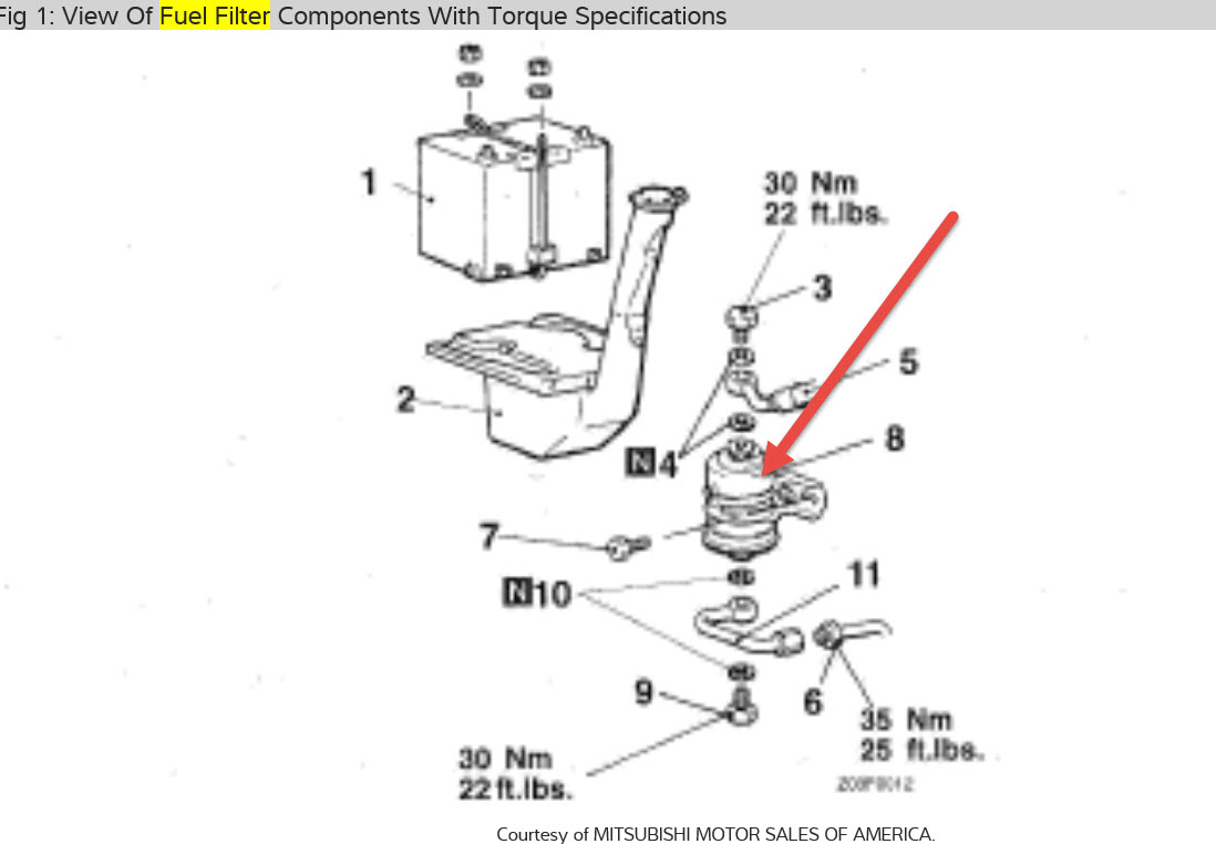

go to our site under fuel then filter for video yours may be similar although you need to remove battery and battery box to reach it if it's a 3.0L
Image (Click to enlarge)
