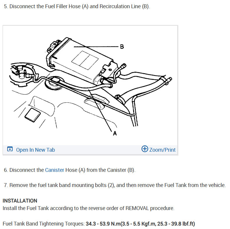

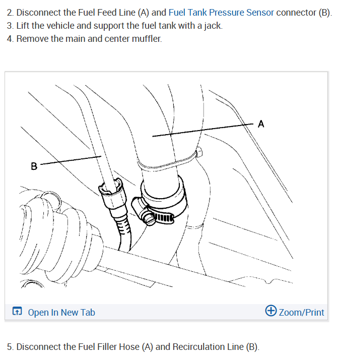

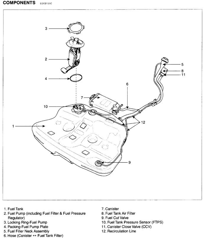

Need to know how to go about changing the rubber hose that goes from gas fill tube to the tank.
May 18, 2025 at 12:55 PM
  • CAR REPAIR CONTRIBUTOR
  • 54,436 POSTS
Np, I would make sure the gas tank is close to empty or drain the fuel out. Please watch this video, also do not smoke or have an open flame around the fuel.
https://www.youtube.com/watch?v=Q5MH2gnyFH0
They don't give us the step by step but if you check out the image below it shows the parts and what you should remove to get the job done. Check out the images (below). Please upload pictures or videos in your response of any problem you may have, and I will help you :)
