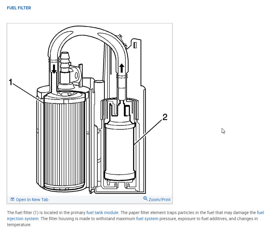

Fuel filter location
2005 CHEVROLET EQUINOX
160,000 MILES
DAVID GAAR
Need to locate the fuel filter on the vehicle listed above.
Sep 11, 2020 at 4:37 PM
  • CAR REPAIR CONTRIBUTOR
The fuel filter on this engine is part of the fuel pump assembly located in the tank. Take a look at the attachment.
The filter only requires replacement when the tank is dropped for another reason or there is an issue that requires its replacement. It is not a maintenance item.
Let me know if there are other questions. Thanks
Sep 11, 2020 at 5:18 PM
DAVID GAAR
Thank you.i figured out the problem it was a lose relay switch from jumping a car last week.
Sep 11, 2020 at 5:39 PM
Okay. I assume the vehicle was not starting and you were thinking the fuel filter was plugged? Just trying to make sure we know what that loose relay switch fixed so that others can figure the same thing out if they visit the site. Thanks
