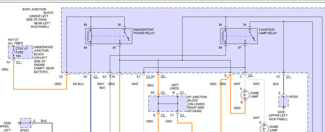

Where is the interior light fuse?
Saturday, July 9th, 2016 AT 9:11 PM
HMAC300
MECHANIC
48,601 POSTS
It is in the under hood fuse block as well as a relay. See picture. Fuse should be marked on under side of cover.
Image (Click to make bigger)
Sunday, July 10th, 2016 AT 8:45 AM
